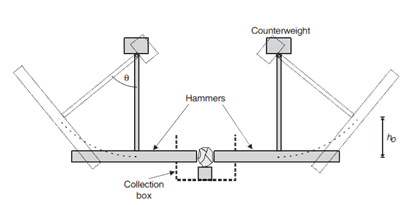

Calibration tests
Materials can break either by high impact forces or by low-energy stressing events. The fundamental properties of the fracture process can be studied most effectively by well-controlled experiments on single particles and/or small volumes of material thus suitable calibration tests have been designed over the years.
The traditional approaches to measure the fracture characteristics of particles under repeated impacts include drop weights tests and the Hopkison bar. A more sophisticated method, that is the result of the hybridization of the aforementioned standard approaches, is the Ultra Fast Load Cell (UFLC – Fig.2), where steel balls strikers are dropped from various heights with the aim to produce desired impact energies (King and Bourgeois 1993, Tavares and King 1998, Tavares and King 2002). The advantage of this method over others is the fact that does not contain empirical constants in the calculation of the overall deformation between contacts, and therefore, absolute calibration is possible.
Alternative single-particle tests include slow compression tests (using uniaxial compression presses and pendulum tests), drop-weight loading and ballistic impact loading. Each of these methods allows investigation over a restricted range of strain rate and, because the size distribution of the progeny is dependent on the strain rate, the experimental method must be carefully chosen (Tavares, 2007).
Figure 4 – Schematic of the (a) UFLC Tavares 2002, (b) experimental setup by Barrios et.al. (2015) and (c) a standardized apparatus by Bond (1946).
The following table provides a list of different materials and the description of their breakage parameters provided by literature (Tavares, 2007 and de Carvalho, 2013) measured from the previously described calibration tests.
