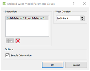

EDEM also allows you to deform geometry according to the quantitative results given by the Archard Wear model. To enable this feature, select Enable Deformation in the parameter values GUI as shown.
