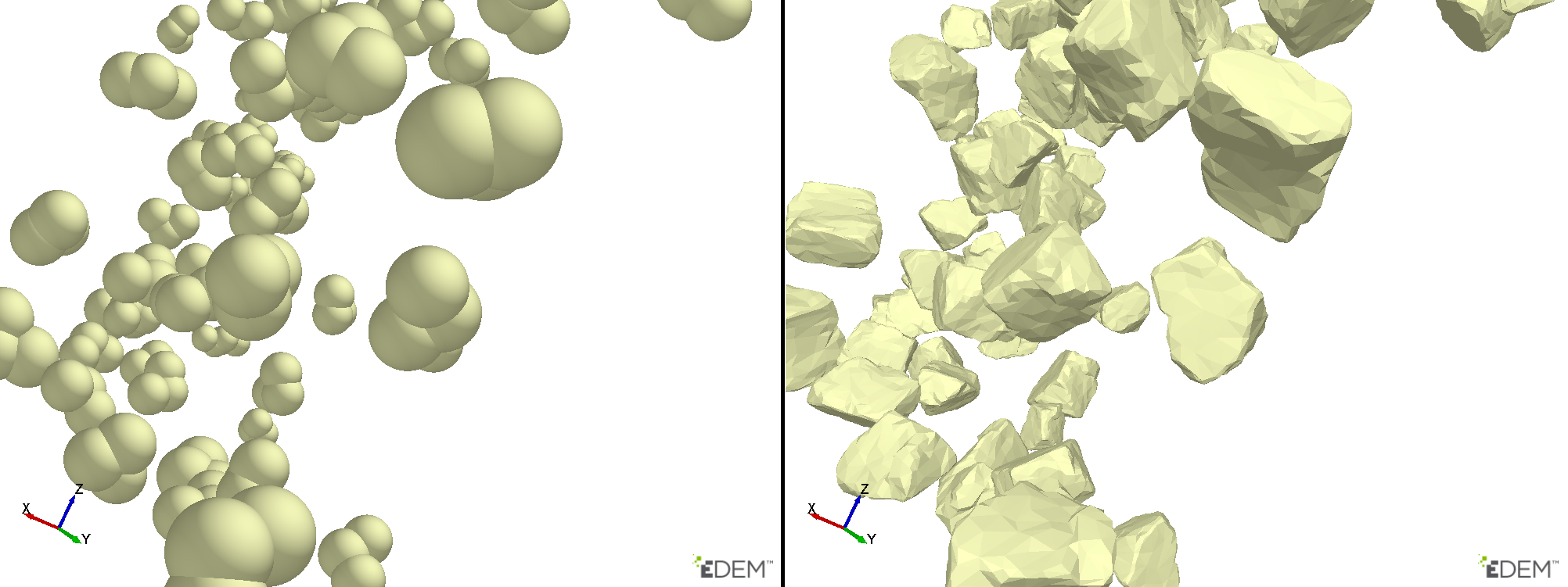

Model the particle shape using the highly validated and computationally efficient Multi-Sphere method
Automatically create complex shapes using the Sphere Fitting tool
Easily create flexible materials and fibers using the Meta Particle feature

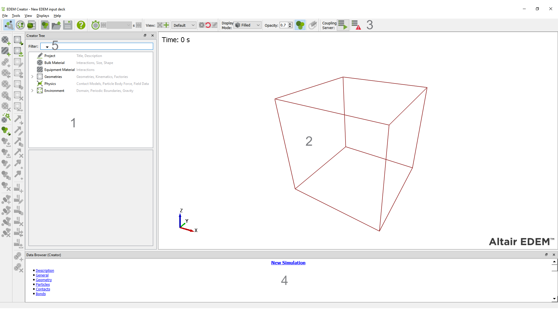

Creator Tree
Viewer
Creator Toolbar and Menu Bar
Data Browser (Creator)
Tree Filter
Creator Tree
The Creator Tree is displayed on the left side of the EDEM window. It contains information about the Project, Bulk Material, Equipment Material, Geometries, Physics, and Environment.
Viewer
The Viewer displays 3D representations of your particles, geometry, and fields (if applicable). You can control the rotation, position, and zoom factor of the Viewer using a mouse.

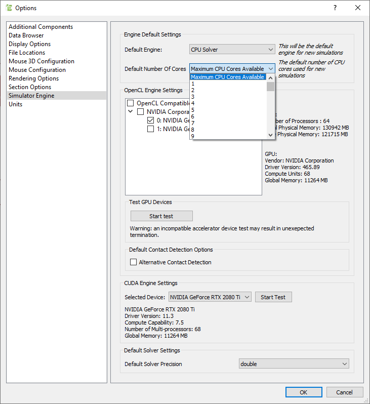

- Simulator Engine
Select the standard or GPU simulator engine. On creating a new simulation, the Simulator Engine will default to the one set in the Tools Menu. In the Simulator, you can change the engine used and this information is stored for every simulation in the simulation_name.dfg file. While opening existing simulations, the displayed engine will have the last saved setting for the simulation.
When starting a new simulation, EDEM defaults to the Maximum Cores available on the local PC. You can set the default number of cores using the Simulator Engine > Default Number of Cores menu. This can be set once for every user and then EDEM will default to the selected setting.
