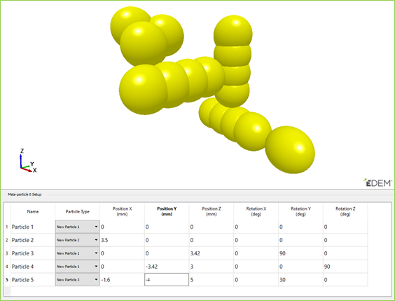

- In the Creator Tree > Bulk Material, select the newly created Meta-Particle.
- In the empty dialog box, right-click and select Add Particle. Repeat to add the required number of particles for the desired Meta-Particle.
- In the Particle Type dropdown, select the particles that will make up the desired Meta-Particle.
- To add, remove, or copy a particle from the setup, use the following icons:
. - Use any combination of different particles to form Meta-Particles (this is not restricted to the same Bulk Material).
- Use any arrangement that allows bonding upon creation.
- Arrange the particles using the X, Y, and Z positioning and rotation coordinates so that the particles are next to each other with minimal overlap or separation.
- If the particles are significantly overlapping, they will repel and break apart when the Meta-Particle is created.
- If the particles are spaced too far apart, they will not bond with each other during the creation process and the Meta-Particle will not form correctly.
