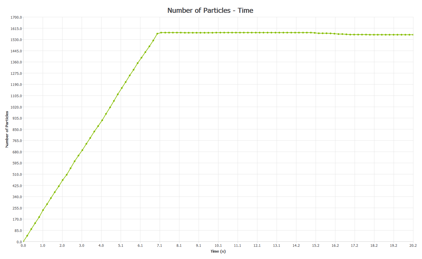

Configuring the X-Axis
In a Line graph, the X-axis measures time.
Click the X-axis tab.
Specify the Start and End values to define the time interval over which your data will be plotted. (Grayed-out time steps indicate partial saves and may not contain all the data you want to plot.)
Select the Logarithmic Scale checkbox to to display logarithmic time increments along the X-axis.
Set the number of intervals on the axis: (A greater number of intervals increases the accuracy of the chart.)
Set the maximum number of points that will be displayed. (Reducing the number of points may improve the readability of the graph.)
Configuring the Y-Axis
Click the Y-axis tab and select the element attribute and component to be plotted on the Y-axis.
The attributes available in the list will depend on the elements previously selected. A component type can also be selected for certain attributes. This is used to determine which value will be graphed for a particular attribute component: For example, maximum, minimum, or average particle velocity.
To define several attributes in a different Y-Axis and visualize them in the same Line graph, add Y-Axis to the dropdown, and select and define each of the attributes. You can visualize all the attributes in the same scale by enabling the Display same axis scale for all Y axes checkbox.
When plotting the number of elements (number of particles, contacts, or collisions) any interpolated data points (those constructed from the discrete set of known data points) are rounded off to the nearest whole number.
The Histogram (with the exception of collisions and Torque) and Line graphs have the same element attribute options.
