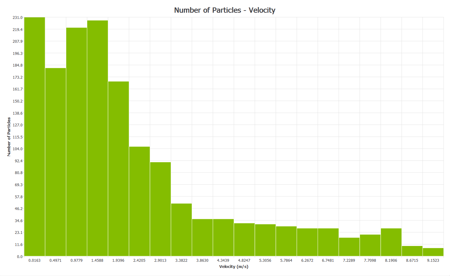

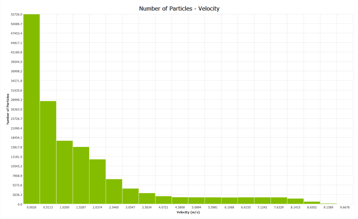

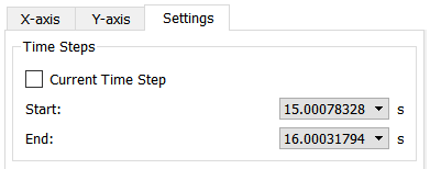

You can configure the settings for elements in a particular Time Step or over a range of time steps.
Time Steps
By default, Current Time Step is selected. To modify the Current Time step, use the Current Time control in the Viewer control pane at the right of the screen. For example, the following histograms show the distribution of particles traveling in particular velocity ranges - one one Time step, so each particle is only counted once, and the second for a range of 100 time steps.
Unselect Current Time Step to set a different start and end time. Grayed-out time steps indicate partial saves and may not contain all the data you want to plot.
