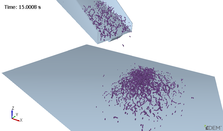

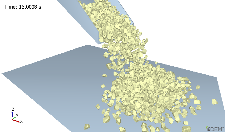

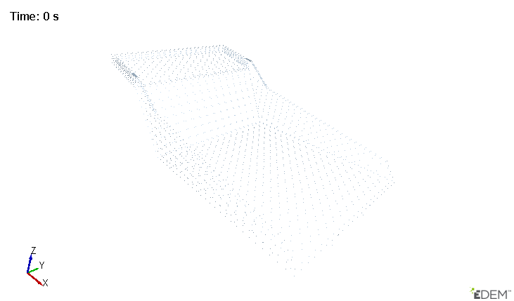

  2. Display Mode allows you to select between filled, mesh, or point style display. The mesh option can be used to display the triangular elements the section is made up of. The points option shows the vertex of each element.
    Filled Geometry
Points Geometry

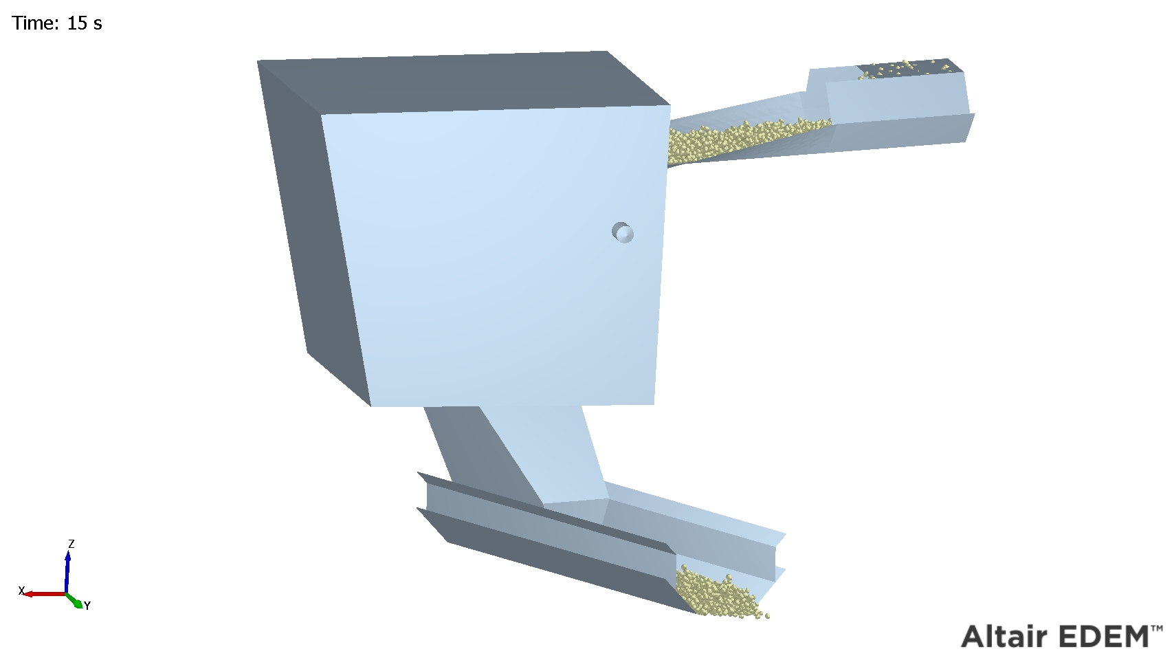

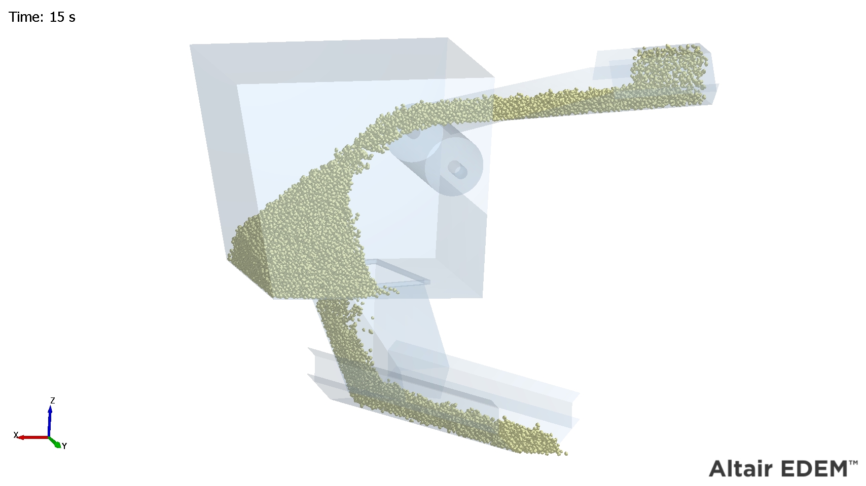

  • Opacity allows you to set the opacity level from 0 (fully transparent) to 1 (opaque).
Opacity of 1
Opacity of 0.75
Opacity of 0.25

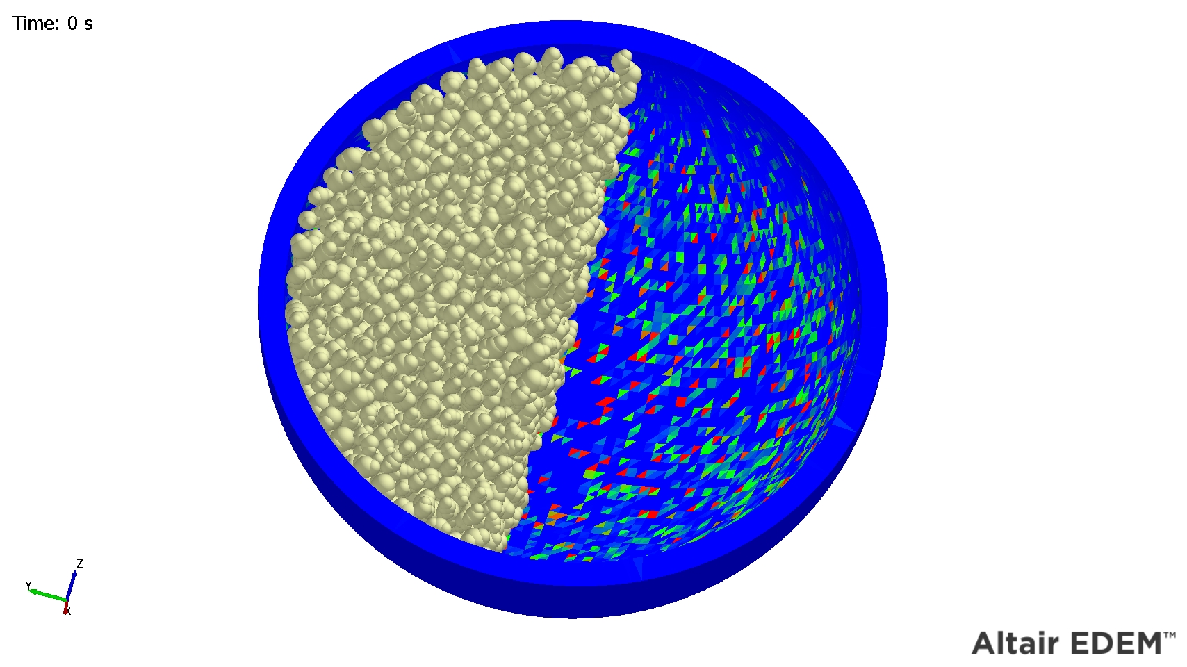

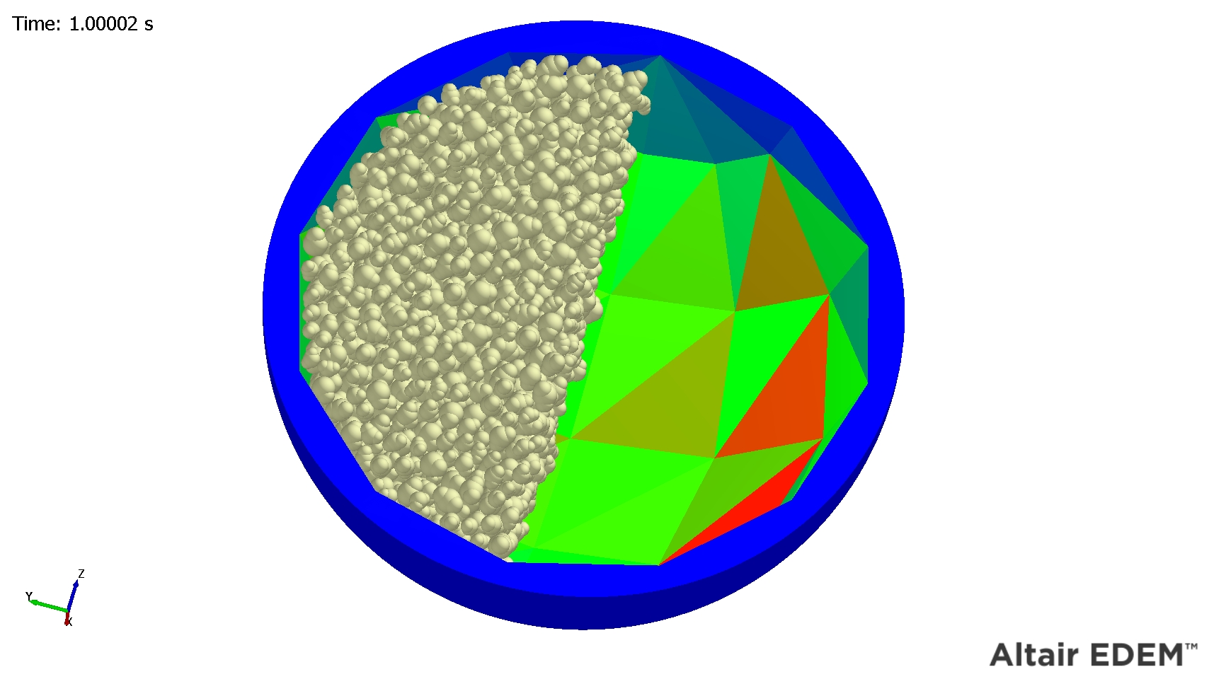

Geometry shown as few mesh triangles, the coloring is split over the the small number of triangles
Geometry shown as a large number of mesh triangles can be seen, the coloring can be shown per triangle.

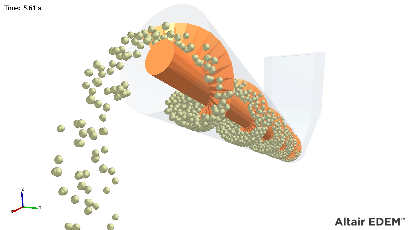

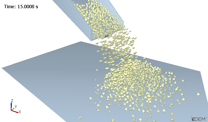

Cone
Particles are displayed as cones. The direction, length and base width of the cone can be set to represent a variety of particle attributes..
  1. Direction
    Represents velocity, torque, total force, angular velocity, or custom property (consisting of exactly three values).
  2. Length
    Represents: velocity, total force, moment of inertia, kinetic energy, mass, rotational kinetic energy, compressive force, torque, volume, angular velocity, or a custom particle property.
  3. Base width
    Can represent: velocity, total force, compressive force, torque, mass, kinetic energy, rotational kinetic energy, volume, moment of inertia, angular velocity, charge, electrostatic force, or a custom particle property.
  4. Particle display reverts to standard spheres when EDEM cannot show particles as cones (for example, if the selected attribute has no values).

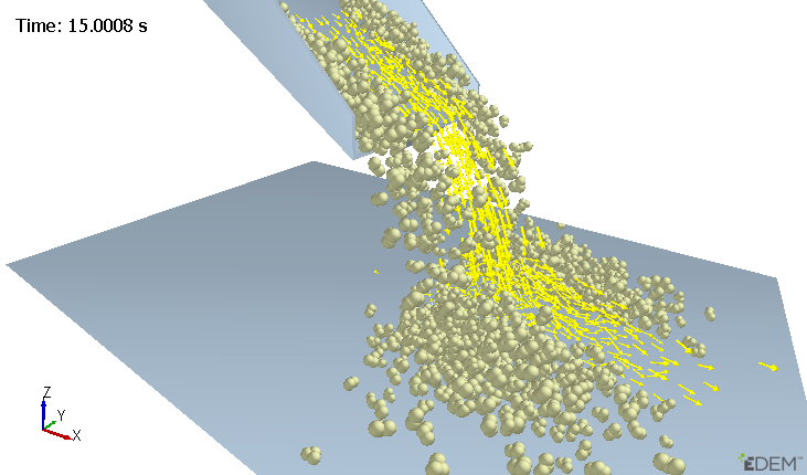

Vector
Particles are displayed as vectors. The direction and length of the vector can be set to represent a variety of particle attributes.
  1. Direction
    Can represent: velocity, torque, total force or angular velocity, or custom property (consisting of exactly three values).
  2. Length
    Can represent: velocity, total force, moment of inertia, kinetic energy, mass, rotational kinetic energy, compressive force, torque, volume, angular velocity, or a custom particle property.

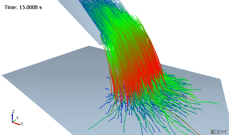

Steam
The path of the particle is displayed as a stream with variable coloring.
  1. Number of Steps
    Define the number of time steps the particles should be streamed for. The number indicates that the streams will be drawn for the previous n time steps up to and including the current Time Step.
  2. Stream All Steps
    Streams are drawn across all Time Steps.
  3. Stream Fade
    Fades the color intensity of the streams.

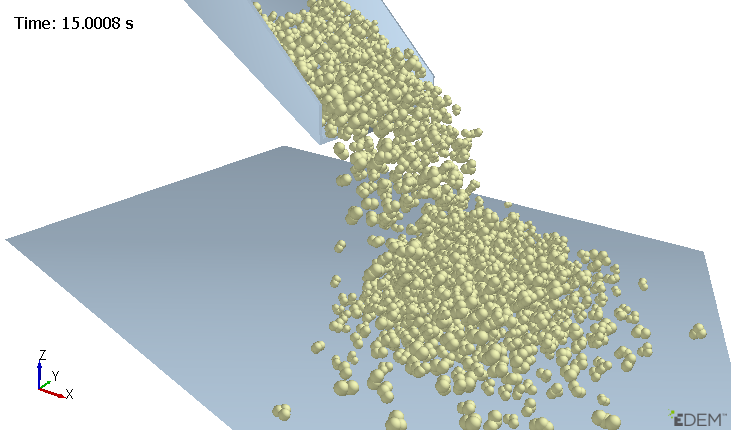

Particles are displayed using one of the currently imported templates.
  1. Texture loads an image file (*.png, *.bmp or *.jpg) to use as a texture on particle surfaces. Textures can only be loaded on to particle surfaces when the particle representation type is set to Template.

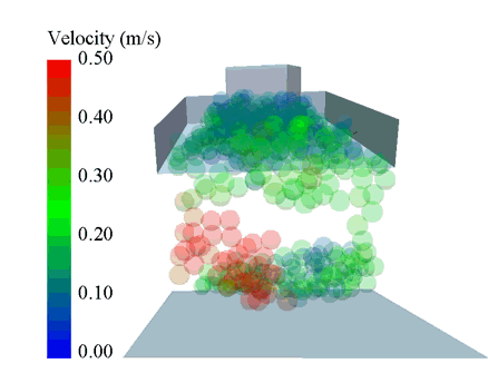

  2. Opacity sets the particle opacity level from 0 (fully transparent) to 1 (opaque). Select the Opacity check box and set the value of opacity to between 0 and 1.
    Example of particles colored by Velocity with Opacity set to 0.25:

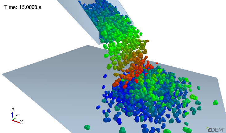

    Color By - Attribute allows you to color any particle of the model by a particular attribute: For example, the following figure shows all particles colored by velocity. The particles with the greatest velocity are colored red, and those with the lowest colored blue.
  4. Select the element to color from Color By selection, then select the attribute to color by.
    The attributes and their components available for each element are listed in the table below.

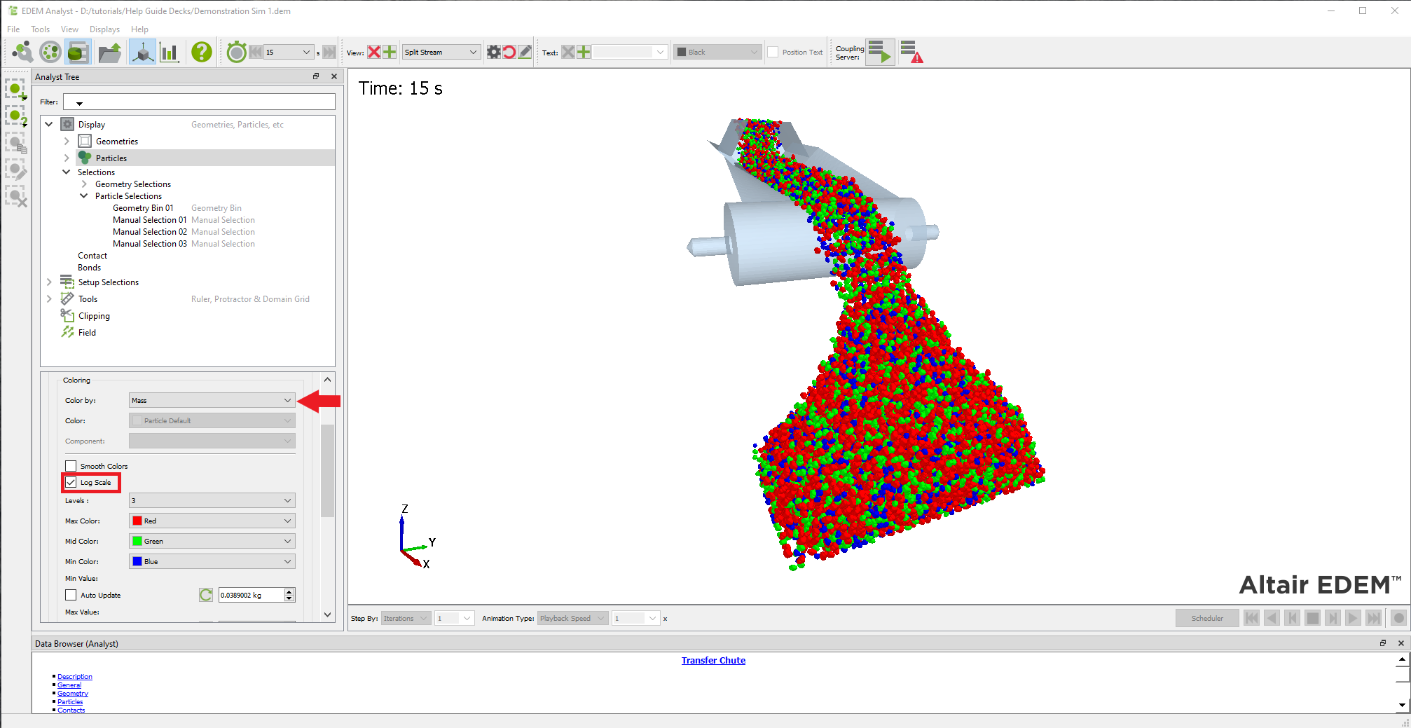

Log Scaling Coloring
Coloring of particle attributes can be scaled logarithmically for better color distribution. This feature allows you to change the coloring from linear to logarithmic and is active for particle Mass and Volume only.
With Particles selected from the Element pulldown, select an attribute to color by Mass or Volume then select the Log Scale checkbox.

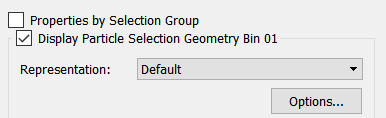

  1. Properties by Selection Group checkbox
    For selections, enable or disable if the properties are set for each selection group. This works with the display and color by checkboxes.
  2. Display checkbox
    Enables or disables the display of the selection. For example, if a Manual Selection of particles is highlighted as shown, you can choose to display or hide this selection.

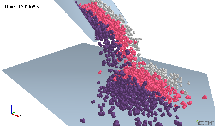

    Display box selected
Display box not selected
Display Mode
  1. For equipment, select filled, mesh, or point style display. For particles, select default, cone, vector, stream, or template.
Selected group of particles displayed by Vector while remaining particles shown as default:
  1. Color by Selection Group checkbox
    If enabled, you can color only the selection group following the Coloring settings.

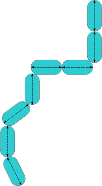

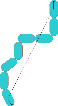

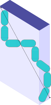

Length Bounding Box
The bounding box method creates a bounding box around the Meta-Particle and then calculates the diagonal for that box.
Length Extent
The extent based method adds the length or diameter of each element in the system. This is good for long continuous meta particles. This method assumes that sphero-cylinders are bonded end to end.
Length Distance-based
The length-based approach takes the two further-apart particles and calculates the distance between those two particles.

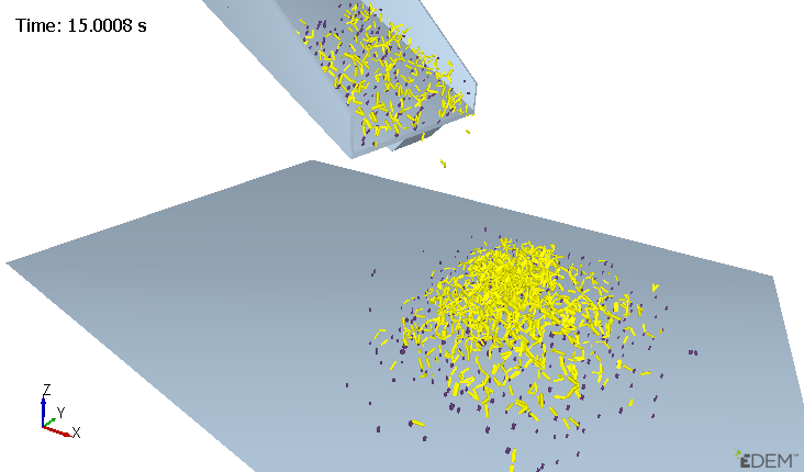

Standard particle displayed
           Particles not displayed and all contacts are displayed
  1. Display Contact Attributes
    1. Contact Vector
      Displays an equal sized cylinder between all elements selected.
    2. Normal Force
      Scales the contact vector option by the magnitude of the contact normal force.
    3. Normal Overlap
      Represents the contact as a flat plate between the elements.
    4. Tangential Force
      Scales the contact by the magnitude of the contact tangential force.
    5. Display Contact Opacity
      Change the opacity of the contact display.Display Contact Coloring
  2. If you select Color by Uniform, the contact group or groups will be visualized by the defined color.
    Particle-particle contacts colored yellow with particle-geometry contacts colored purple.

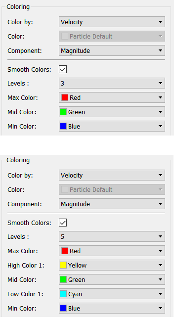

Max Value defines the value of the selected attribute that is going to correspond to the color assigned for the maximum in the legend.
Auto Update enables the checkbox to allow EDEM define the minimum/maximum values depending on the calculated results.
Hide out of bounds hides all the particles when Auto Update is not enabled, and if the value of the attribute colored is outside of the minimum and maximum range.
Coloring Legend
Allows you to display a color legend in the Viewer.
  • Select Position Legend and click anywhere in the Viewer to position it.
  • Click Legend Options to set the legend’s width, height, number of intervals, alignment, and title.
Select Hide Legends to remove legends for all selected elements.
