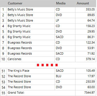

When Monarch Data Prep Studio builds a summary, it generates a list of all unique values found in each key field. These lists are combined to form the summary matrix. Each line in the summary matrix represents a set of unique key values. For example, in the following summary, the fields Customer and Media are used. The Customer field contains 20 unique values, one for each customer in the report. The Media field contains 5 unique values, one for each media type in the report. In combination, these two fields can create a summary matrix of up to 100 lines, (20 customers * 5 media types). In practice, the summary would likely contain fewer lines, since not all media types are present for each customer (see illustration below).
Summary matrix created for 20 customers and five media types.

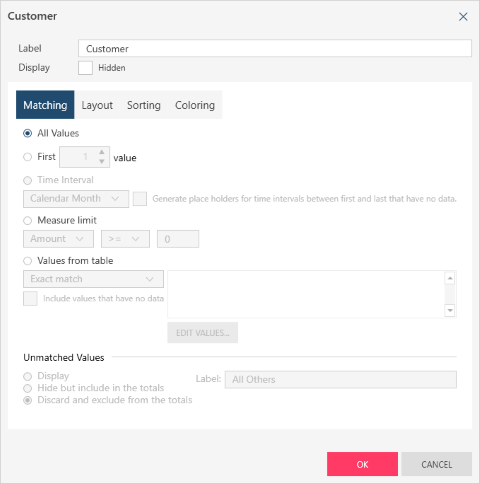

In the Edit Summary dialog, click the Edit icon of a key field to display this field's tabs and properties.
Go to the Matching tab.
Select the radio button of the appropriate Match option.
Select All Values to build the summary using all key field values.
Select First N Values to build the summary using the first n values in the key field (based upon the sort order applied when the summary is built).
Select Measure Limit to build the summary using only those key field values for which a selected measure subtotal falls above or below a specified limit. Select the measure from the associated drop down list, then select a comparison operator and enter a limit value in the adjacent box.
Select Time Interval to build the summary using only those key field values that fall within the specified time interval.
Select Values from table to create a list of specific values that Monarch Data Prep Studio will use for each key field, as well as specify the mapping of the values to that list.

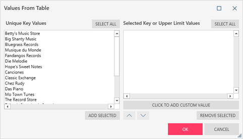

If you selected the Values from table option, click the Edit Values button to display the Values from Table box:
You can:
Select a value or all values from the Unique Key Values panel and then click Add Selected.

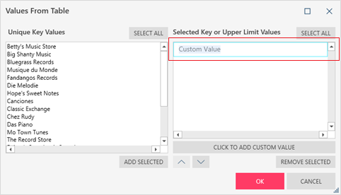

Enter a value directly into the Selected Key or Upper Limit Values panel by clicking on the Click to Add Custom Value button, double-clicking on the Custom Value key and then entering a new value.
Select a value or all values in the Selected Key or Upper Limit Values panel and then click Remove Selected.
Click OK to complete the Add operation.
If you selected the Upper Limit Values option, use the New Value button to add each upper limit value to the Specified or Upper Limit Values list, then click OK to close the dialog.

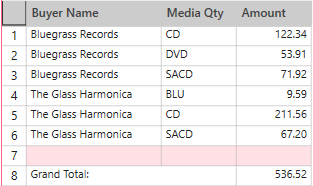

Using specified values to display information for only two customers (Bluegrass Records and The Glass Harmonica).

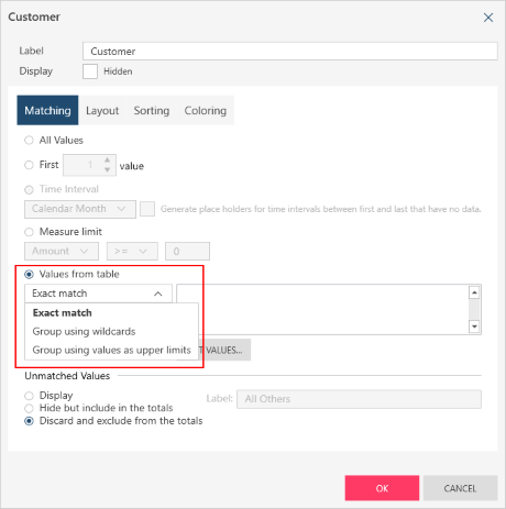

Within Values from Table, you have three mapping choices:
Exact Match
Using Exact match, you only group according to the key values that are listed. In the example above, you only group according to the four customers listed.
Group using wildcards

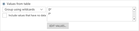

Group using wildcards works almost like Exact Match, but in this case you can use wildcard characters to specify the key values to include. In this way you do not have to enter all values exactly.
In this example, we specify to group only according to Customers that start with D and F:
And we get a summary like this:

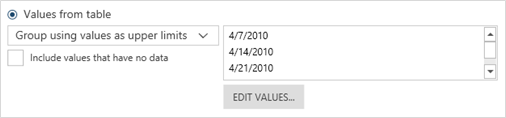

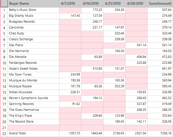

For key fields that contain date or numeric values, a somewhat different type of list might be desirable. For dates and numbers, you can create a series of ranges by specifying the upper limit for each range (e.g., 100, 200, 300 or 04/07/2010, 04/14/2010, 04/21/2010, etc.).
Using upper limit values to group Ship_date values into weekly ranges.
