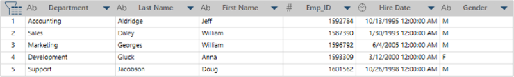

As an example, consider the following table:

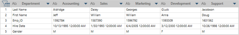

When you transpose on the first column, i.e. Department:
Each Department value becomes a column header
Each Employee row associated with the department becomes a column, and all row values are listed below each department.
The resulting transform will look like this:
The original column headers are transposed as row values of the first column and what used to be column values now become horizontal records.

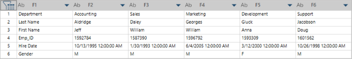

You can also transpose and use generic column headers so that the original column headers become another column:

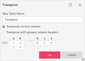

Select Transpose to display the Transpose dialog:
Select one of the following:
Transpose on first column
Tranpose with generic column headers.
Select OK when you are finished.
The new table is named Transpose. You can then rename the table as needed.
