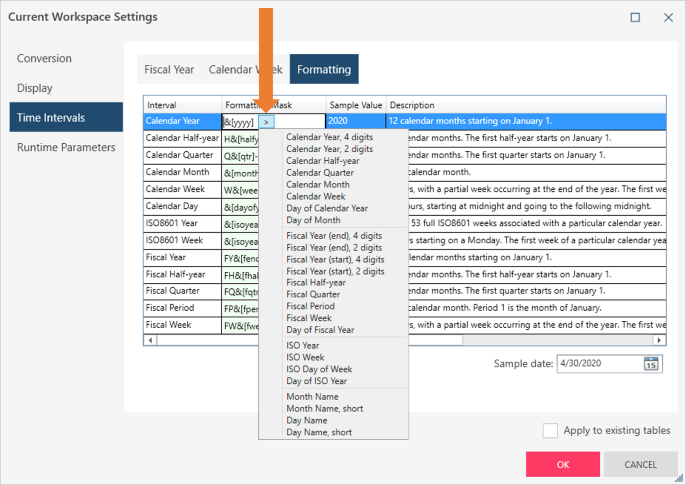

Defining time interval formatting
Use the table to define formatting for all time intervals used by Monarch Data Prep Studio.
Field |
Description |
Interval |
Lists the names of the time intervals available. |
Formatting Mask
Displays the formatting mask applied to the currently-selected interval. To edit the formatting mask, double-click on the desired time interval mask and then click
Sample Value
Shows the effect of the formatting masks on the sample date. The sample date is displayed on the lower-right corner of the dialog, and you can change the value using the calendar control beside it. |
Description |
Displays a description of each time interval.
to select from a list of available masks:
