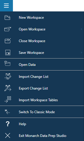

Select the Application Menu icon on the upper right corner of the window you are in:
Select Open Workspace or Open Workspace from Altair Monarch Server Library.
