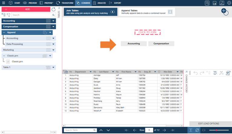

After loading data into the Prepare Window, click Combine > Join to activate the Joining Stage.
Do one of the following:
Drag a table from the table selector to the
drop box. -
Drop a table from a location on your machine (e.g., from your desktop or local/network drive) to the
drop box. -
Double-click on a table from the table selector to add it to the
drop box.
Select a second table following the same procedure in Step 2.
The tables you selected or dropped are displayed on the join work area:
If you wish to replace any of the tables in the join work area, hover over the table to be replaced and then click on the Remove icon.
Then, drag and drop a new table into the table drop box.
A preview of the data in the active table displays.
Select the Click to Join button.

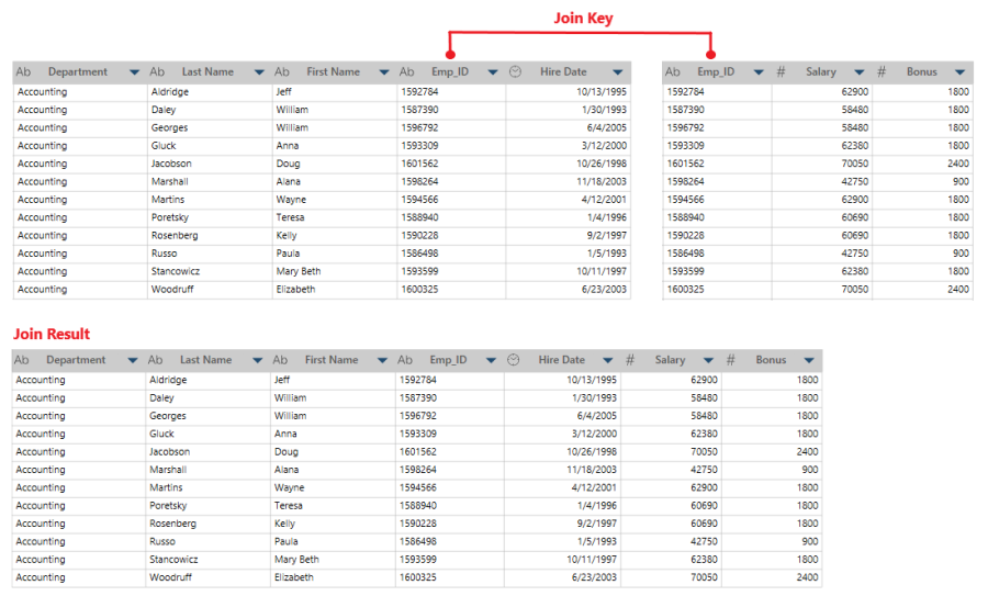

Select the Join Keys.
Join keys are the columns that will allow you to match the rows in one table with the rows in another. For instance you can link an Order table with Order Details using Order ID as the join key.
To select join keys, select the key icon on the left table with the matching key icon of the matching column in the right table:
You must use two fields that have the same data type as join keys.
The join keys just selected are displayed above the column list:

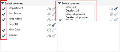

Select or unselect the fields you want to included or exclude in the resulting table.
Click on the checkmark beside a field to include or exclude this in the result table:
You can also select other options to:
Select or deselect all columns
Select or deselect duplicate records.

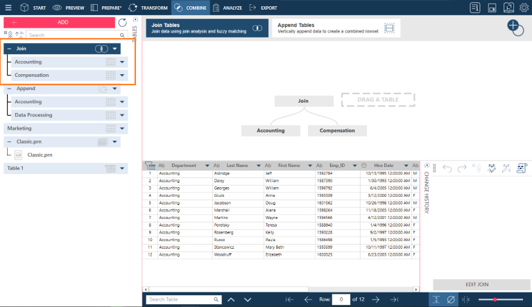

Select OK to complete the join.
The new table is included in the table list. A join icon beside the new table's name indicates that this is the result of a combine operation. Also, the table that have been combined are displayed below the join.
If you want to join another table with the result, select another table and repeat the steps above.
If you want to transform the resulting table, go to the Prepare Window.
Monarch Data Prep Studio assigns sequential default names to the Join result, i.e.: Join, Join(1), Join(2). Rename the result as needed, following the steps in Renaming a Table.
If you want to edit or discard the join, select the corresponding option from the drop-down beside the Join table:

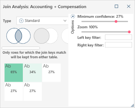

Monarch Data Prep Studio can analyze your two tables and recommend the best join keys to use.
The dialog then shows which join fields will produce the best results (the higher the percentage value, the more rows are joined by a join key combination). To determine the join field combination, hover over a percentage value:
In this example, the mouse is hovered over the box marked 65%. The pop-up notifies you that using Emp_ID from the Accounting table and Emp_ID from the Compensation table will produce a 65% match.
In the Edit Join dialog, select Recommend Keys.
The Join Analysis dialog displays:
Select a Join Type from the drop down, and then the actual join operation.
You can play around with the analysis further. For instance, you can:
Select a different join type from the drop down and a different join operation to see if you get better join results.
Display the Options panel:
...to do the following:
Set a minimum match: Move the slider to control the percentage match that displays. For instance, you can ask Monarch Data Prep Studio to show only percentage matches 95% and above. Then you can click on the boxes that display to view which keys you need to join to produce those matches.
Zoom: Move the slider to make the boxes bigger for better readability. This functionality is helpful if there are a lot of percentages boxes that are displayed.
Left/Right Key filter: Enter key values to see if you get better matches if some values are suppressed.
If you are satisfied with a projected join result, click on the box reflecting this result to initiate the join. The Edit Join dialog displays once more.

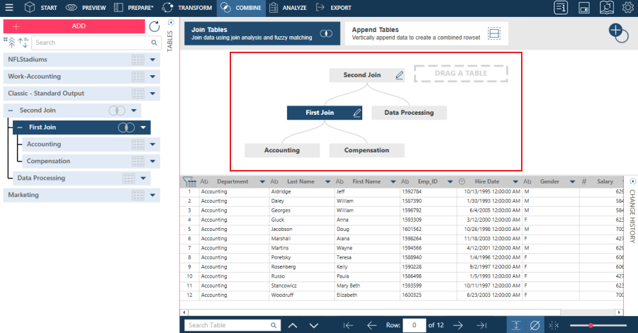

Creating multiple joins
Multiple joins in a single join session are supported in Monarch Data Prep Studio. If you would like to create multiple joins (e.g., join three tables into a single table), complete the join operation for the first two tables and then initiate another join operation to combine the resulting joined table with the third table. You can join as many tables as you wish following this process as long as the join condition stated above (i.e., the two tables have a common join key) is observed.
