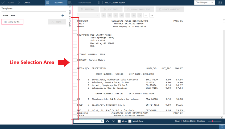

Select a line or group of lines that contain a single instance of the detail fields. Note: To select a single line, click in the line selection area to the left of the line. To select multiple lines, click down in the line selection area to the left of the first line, then drag down to the last line, then release.

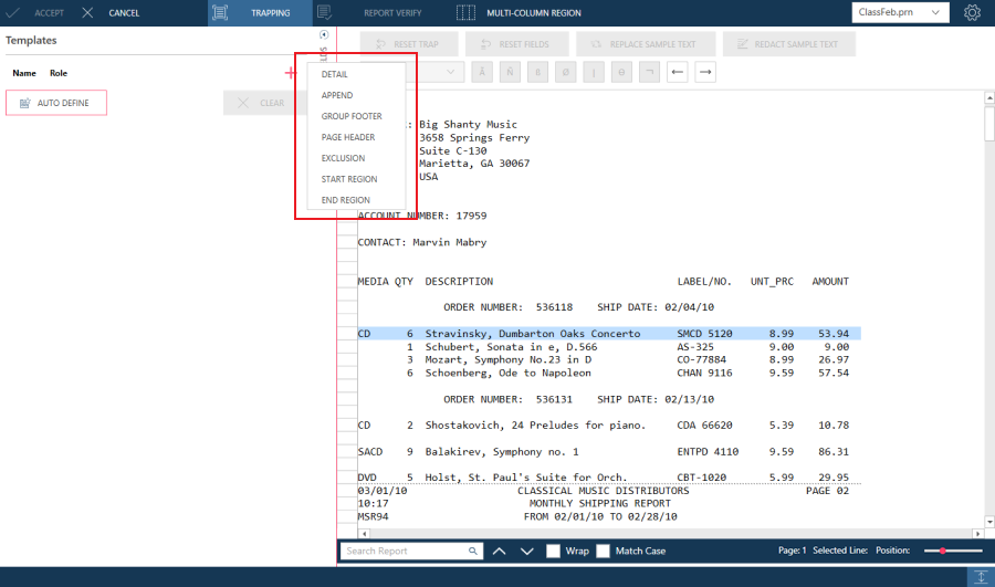

In the Template and Field Properties Panel, select Add a New Template
and then select a template role:

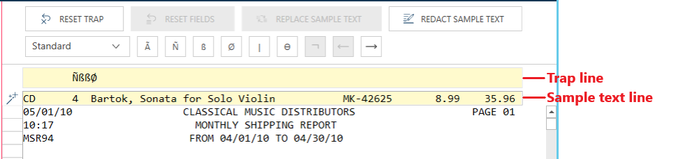

You create a trap by entering trap characters in the Trap line as shown below:
The Sample text line and the Trap Line. The Trap Line has one numeric trap defined.

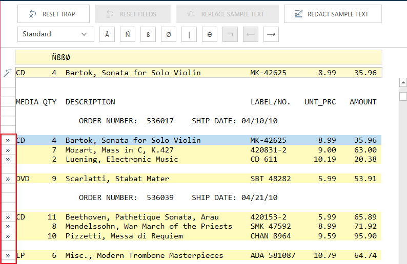

As you create your trap, portions of the body of your report are marked with guillemets in the Line Selection area to confirm that the data in them will be captured. You can use these marks to check that your trap is correctly defined.
You can specify one or more trap characters on the trap line. Often, several different combinations will work equally well. It is generally a good idea to specify several trap characters to ensure that you do not accidentally capture lines from other sort levels, but be careful. If you specify many trap characters, you run the risk that some lines will be missed by the trap. You can experiment with the trap definition until you find a combination that works.

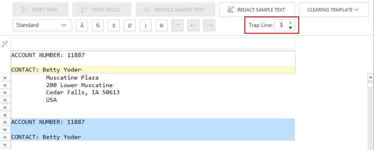

In some reports, the detail fields are arranged on more than one line, e.g., a block of text. As well, occasionally, there may be no unique features that identify the first line of a block of text. If it is impossible to use line 1, select another line that has unique features. In this case, you need to indicate which of the sample lines to trap on via the Trap Line field.

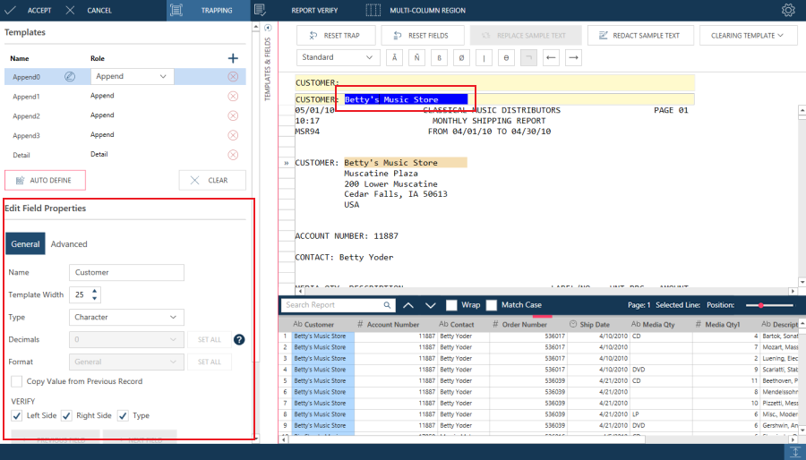

You can name each field via the Field Properties portion of the Template and Field Properties panel. By naming fields within the context of the report, you may find it easier to determine appropriate field names.
Click a field you wish to rename in the Sample text line.
The Field Properties portion of the Template and Field Properties panel displays the sample field value for the selected field along with the current field name. If you have not yet named the field, it is automatically given a temporary name.
Create an appropriate name for the field by clicking into the Name box and replacing the current entry with a new one. Click on the checkmark that displays next to the field to accept the field name.
Field names may be up to 62 characters in length and may contain uppercase and lowercase characters, spaces, and punctuation except for period (.), exclamation point (!), accent grave (`) and brackets ([]). Names may begin with any character, except for an underscore or space. If a name is entered with leading spaces, the name is accepted but the leading spaces are ignored.
Note: If you elect to enforce DBF field naming rules, field names must adhere to the dBASE III field naming conventions. Names may be up to ten characters long and may contain any letter or number and the underscore character (_). The first character must be a letter. Spaces and punctuation are not allowed.
Repeat steps 1 and 2 for each field to be named. If several fields are defined in one template, you can display the properties of the next field and rename it by selecting the Next Field button at the bottom of the Edit Field Properties panel.
