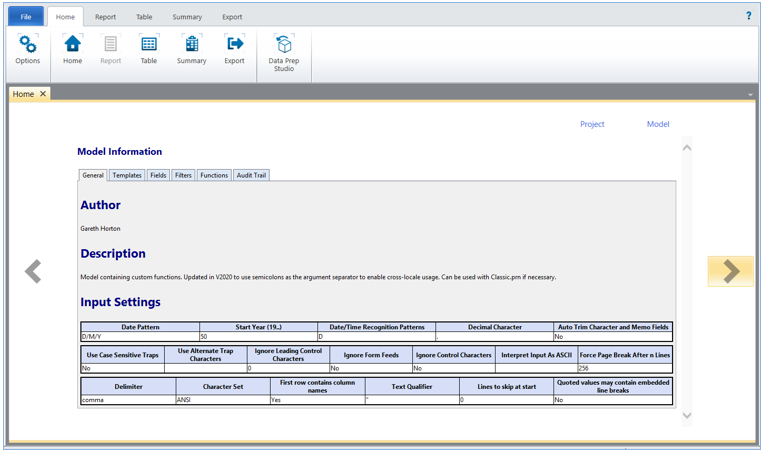

Monarch saves relevant information each time a Model or Project file is created.
This information includes the author of the model as well as its description, all defined templates, fields, filters, sorts, and summaries, and general input settings, among others.
In most cases, model/project information cannot be edited by design. However, Monarch Utility provides an easy way to change such information.

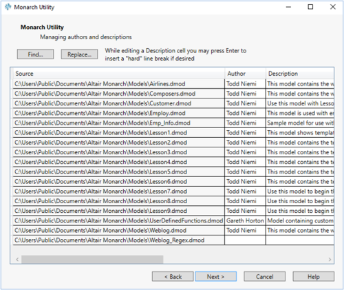

    The next screen displays all of the models and projects containing authors and descriptions you can edit.

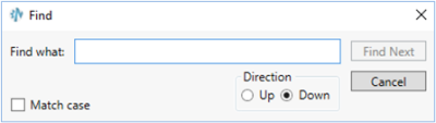

  5. To find keyword(s) in any of the fields in this list, select the Find button, enter the keyword you wish to search for in the Find what field of the dialog that displays and then select Find Next. Continue selecting Find Next to see all instances in which your keyword appears.

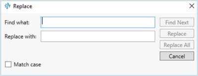

  6. To replace an author name, select the Replace button. Enter the author name to be replaced in the Find what field of the dialog that displays and then enter the name of the name to be used as a replacement in the Replace with field. Select Replace to replace only the next instance of the name indicated in the Find what field or Replace all to replace all instances of this name.

    You can also select an author name to replace by highlighting it in the Author column of the model/project list and then typing in your replacement name. Select Next when you are finished.

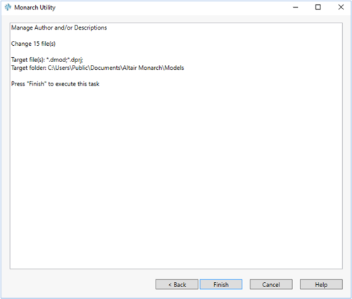

  8. Press Finish to execute the replace all operation.
    To replace model/project descriptions, highlight the description of the model/project you wish to replace in the model/project list, type in your desired description, and then select Next. You will need to select Finish in the next screen that appears to perform the replacement operation.
