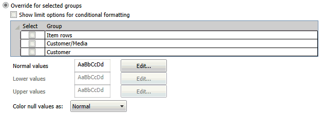

Override for selected groups
Select this option to override the defaults and define colors for specific groups.
If you click on this option a list of groups displays:
Select the groups you wish to color and then click the Edit button beside Normal values preview box to display the Color Properties Dialog. Use the dialog that displays to set the text color, fill color, pattern style and pattern color.
Also select values for Color null values as to set the color for null value fields.

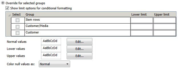

Defining colors for conditional formatting
If you wish to define colors for conditional formatting, click Show limit options for conditional formatting. The screen will provide text boxes for entering the Lower and Upper limits for each group:
Select the groups you wish to color and then enter the lower limit and upper limit values. Click the Edit button beside Normal values, Lower values, and Upper values preview boxes to display the Color Properties Dialog. Use the dialog that displays to set the text color, fill color, pattern style and pattern color.
