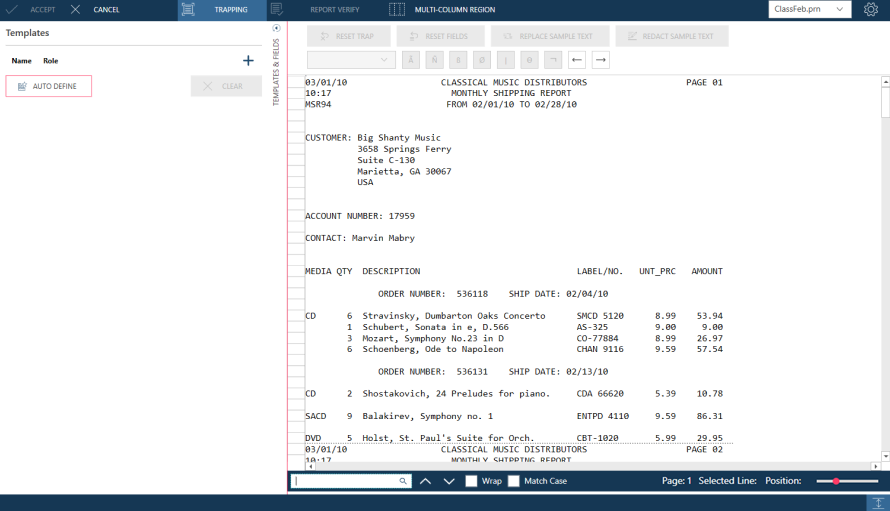

You are brought to the Report Design Window:

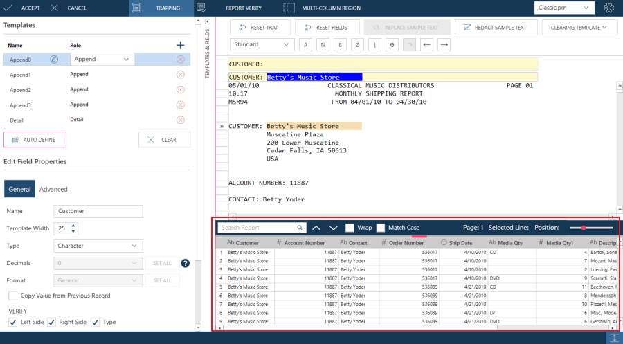

Define templates to extract the data from your document:
To automatically define templates and fields, select the Auto Define icon on the Template and Field Properties panel:
To define templates and fields individually, refer to Overview: Creating Data Extraction Templates. Templates are defined using the Template Editor Action Bar.
When your trapping operations are completed, Monarch Data Prep Studio will create a new column for each field that you define and populate that column with similar field values:

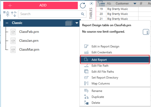

You can load multiple reports into this node by clicking on the drop-down button located to the right of the parent table and then selecting Report Options > Add Report.

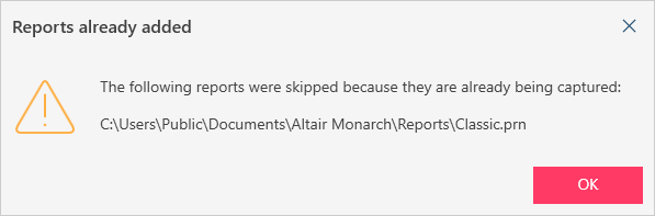

You cannot add the same report that is already being used in the model. In this case, the report will be skipped and will not be added to the model. The following warning popup will display:
