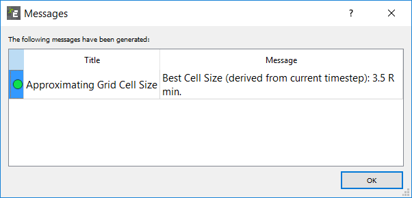

Estimate Cell Size
The estimate cell size is a heuristic algorithm which, based on the current simulation Time Step, will estimate the best cell size. Selecting this option will launch the approximation program and return an estimated best value for simulation performance.
