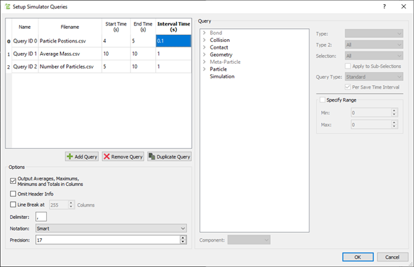

Adding queries to your simulation
When you select the Simulator Queries checkbox, the Setup Simulator Queries dialog box is displayed where you can define queries.
In the Setup Simulator Queries dialog box, the options to define queries can all have a unique Start Time, End Time, and Interval Time similar to those in EDEM Analyst.
After you have defined the queries, start the simulation. The csv files will be copied to the folder which contains the .dem file associated with the simulation.

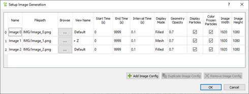

Export Images during run-time
You can generate images of the simulation automatically during run-time. This is most useful during simulation monitoring on remote machines or machines that do not have graphical output.
To configure image export settings:
  1. Select the Simulator tab and then select the Image Generation checkbox to enable image generation.
  2. Click Setup Image Generation… to specify the image setup options.
  3. In the Setup Image Generation dialog box, click Add Image Config to create a new configuration for export and specify the following details:
    For Specify
    Name Specify the identifier for the configuration.
    Filepath Indicates the output path for the images. This path is relative to the simulation’s .dem file. Each configuration will generate many images, numbered sequentially with a suffix. The latest images will also be saved without a suffix, for convenience.
    View Name Indicates the camera location and direction. You can configure available views in the EDEM toolbar.
    Start Time, End Time Indicates the simulation time range during which this configuration will generate images.
    Interval Time Indicates the frequency of the images that will be generated within the selected time range.
    Display Mode Select the display for geometry meshes.
    Geometry Opacity Select the transparency of geometries (0 being fully transparent, and 1 fully opaque).
     Display Particles Select the checkbox to display particles. If you do not select the checkbox,  only geometries are displayed.
    Color Frozen Particles Select to color frozen particles in a light-blue color, especially for simulations using Dynamic Domain.
    Image Width, Image Height Indicates the dimensions of the exported images.
    You can add a number of configurations, each with independent settings.

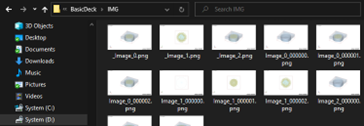

  4. Run the simulation.
    The images will be exported automatically according to the configured settings.

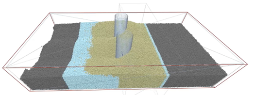

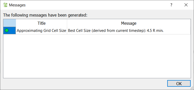

EDEM calculates the smallest particle size in the simulation (Rmin). You then set a grid cell size based on this particle size. 3 RRmin is the default value, typical ranges are 3-6 RRmin, the Estimate Cell Size option provides guidance on the optimal Cell Size for a specific simulation Time Step. The grid does not impact on the simulation results, only the simulation speed. A smaller grid size results in more memory (RAM) usage; reducing the grid cells size below 2 Rmin can result in a significant slow-down for the simulation.
Click the Show Simulator Grid  icon to display the CPU engine/Particle-Particle grid in the Viewer.

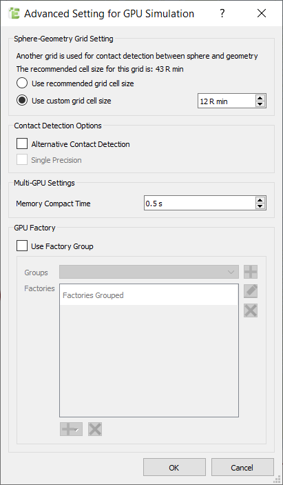

EDEM GPU has a different grid size for Particle-Particle and Particle-Geometry interactions.  The Particle-Particle Rmin size is set in the Simulator Settings tab, the Particle-Geometry cell size can be defined in the Advanced Settings. This is to allow users to specify the optimal grid setting for the GPU Particle-Geometry interactions. Users can use the default ‘recommended grid cell size’ or a custom value. Typically the optimal Particle-Geometry grid setting for GPU is larger than the optimal CPU or Particle-Particle value.
The main computational challenge in DEM simulation is the detection of contacts. By dividing the domain into grid cells, the simulator can check each cell and analyze only those that contain two or more elements (and therefore a possible contact), thus reducing processing time. The results achieved by a simulation are not affected by the number of grid cells, only the time taken to reach them.
The simulation process is as follows:

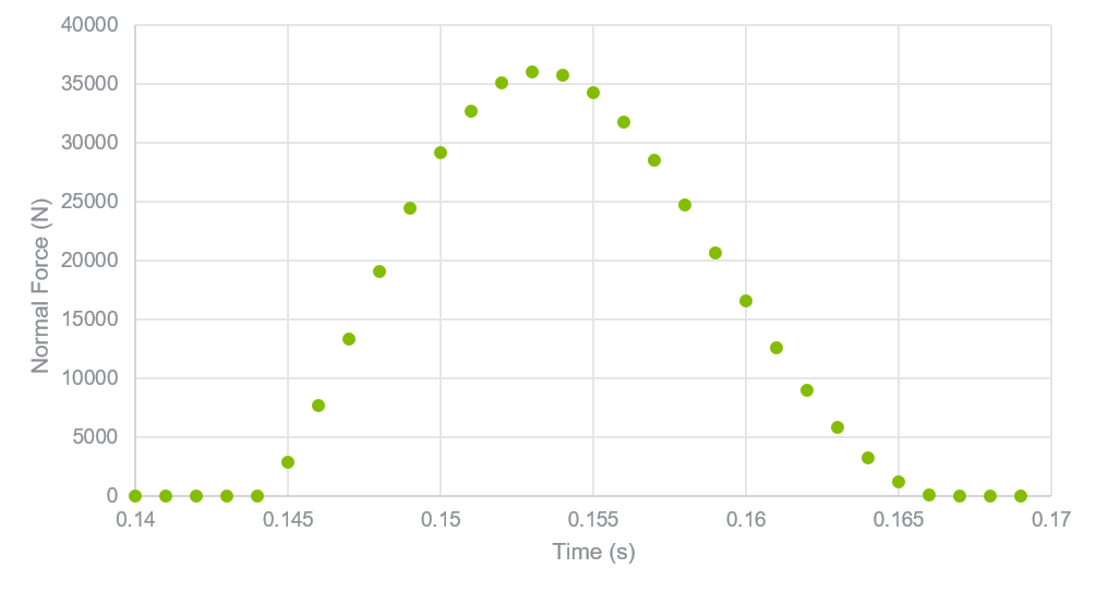

Example force-time graph for a single particle-geometry collision where each point is a contact.
During a simulation, data can be recorded about both contacts and collisions.
  1. Contacts are the impacts occurring between elements at data write-out points. In other words, the contact is in progress when the write-out takes place. The contact has an associated force, position and so on - these are discrete values. If two elements stay in contact with each other for some time such as over 4 write-out points, four contacts will be stored and each of these may have a different force, position and so on.
  2. Collisions are complete impacts.  When two elements collide it will register as one collision, regardless of how long the elements stay in contact for. Data is collected for the duration of the collision. for example, total energy loss, min/max/average normal force data and so on. Collisions may occur in-between write-outs and never register as contacts.
EDEM records all contact data as standard. To record collision data, enable Track Collisions. Storing collision data will significantly increase memory usage and reduce the speed of the simulation. Collision data is stored in memory until it is written out at the rate specified in the Simulator. If a large number of collisions are occurring and the write out frequency is too low, the amount of data being stored in memory will become very large and use up all memory resources. To minimize this, be sure data is written out frequently.

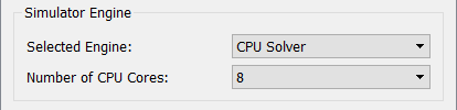

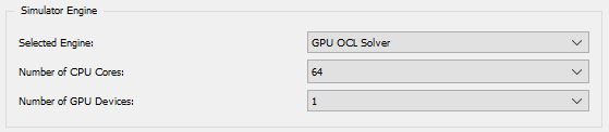

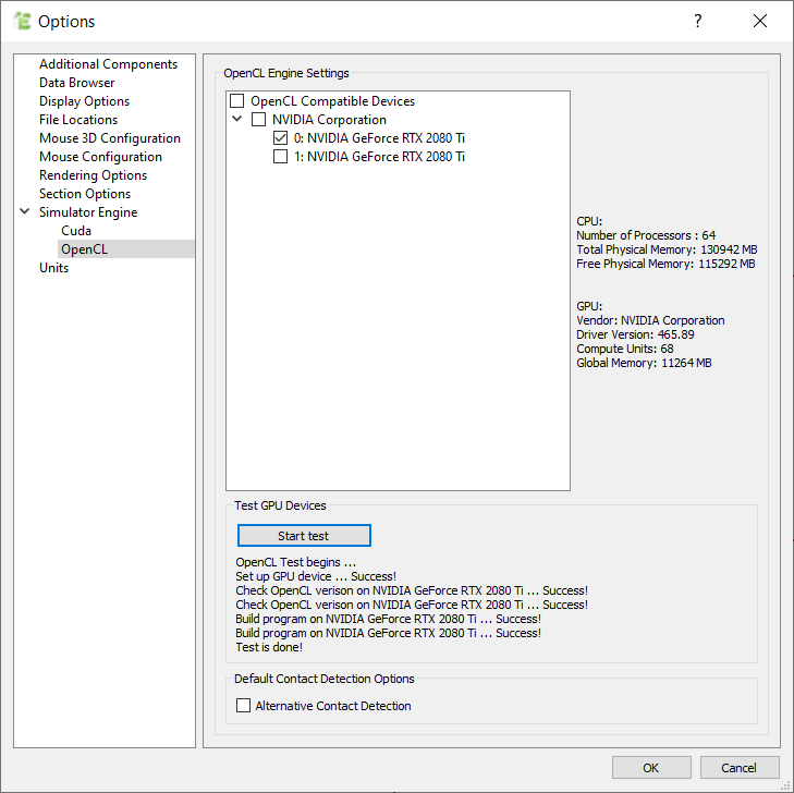

A simulation can run in CPU mode or in GPU mode. GPU mode requires supported GPU hardware. There are two GPU engines, the CUDA engine and the OpenCL engine.  The CUDA engine will run Polyhedral, Sphero-Cylinder and Multi-Sphere simulations and requires a suitable Nvidia graphics card. The OpenCL engine will run Multi-Sphere simulations and will run on any graphics card which support OpenCL.
Selecting Engines

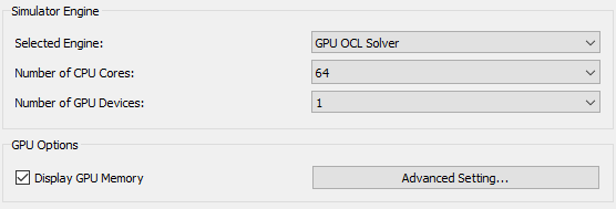

You can select CPU, OpenCL or CUDA Engine. If the GPU option is not available, verify GPU compatibility using the CPU Solver as follows:
3
You can select the number of CPU cores, the number available depends on the CPU hardware available.
The Selected Engine allows you to select the GPU solvers.The number of GPU devices can be set. In addition, you can select the number of CPU Cores, as the processing is handled by the GPU card up to 4 CPU’s are recommended as the optimal value.

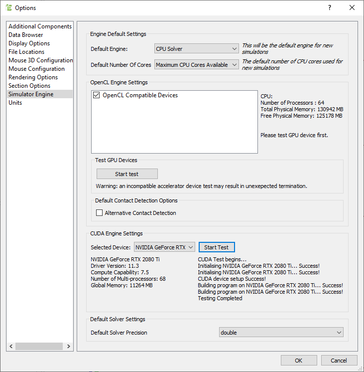

Checking CUDA GPU Compatibility
GPU CUDA engine requires your GPU device to support Nvidia CUDA 11.2 or above. To check hardware compatibility with the GPU go to Tools > Options > Simulator Engine and select the GPU’s from the list and then choose Start test. As shown below EDEM will report if the test and GPU setup is successful. If multiple GPU devices are found a test should be run on each GPU device required to run EDEM.
The test is a standard hardware test for Nvidia CUDA GPU. If the test fails, ensure that your Graphics Card drivers are up to date and try again or contact support with details of the GPU device used.
Only once the test has been run successfully will the GPU option be accessible from the Selected Engine dropdown menu.

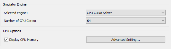

GPU CUDA Solver
When you select the CUDA GPU Solver engine, you are presented with the following options:
Number of CPU Cores
The CUDA GPU engine works with both CPU and GPU. The recommended number of CPU cores when running CUDA GPU is 4 as this provides a good balance of speed vs. CPU use.
Total available memory size
This value shows the value in Megabytes that the percentage above represents for the selected GPU device.

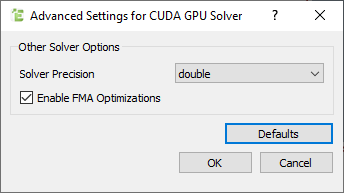

GPU CUDA Advanced Settings
The advanced options for the CUDA GPU solver allow users to modify the precision used for the simulation and disable FMA optimizations.
EDEM allocates a set number of bytes of memory to store simulation information, such as particle position or velocity. The larger the number of bytes it allocates the greater the precision EDEM can work with. By default, EDEM simulations use 8 byte or "Double" precision storage. This means that information is stored at a very high precision. In many applications this level of precision is excessive and has a negligible benefit to the accuracy of simulations. High precision also slows down simulations due to the extra computational expense required to perform operations and slower memory storage/management.
Therefore, there are significant speed benefits to using the lower precision "Single" data type which only uses 4 bytes. It is possible that only using Single precision data may lead to noticeable differences in simulation results, compared to Double precision. Rather than solely using either Single or Double precision a combined, Hybrid, approach can be taken. This is achieved by storing key simulation parameters (such as particle position) in double precision and using Single precision for the remaining properties. The result of this method produces simulations running nearly as fast as solely using single precision, whilst maintaining most of the accuracy of double precision. In order to maintain most of the accuracy of Double precision, storage of key simulation properties is, whilst gaining the computational speed a mixture of these data types can be used in a Hybrid method.

Checking OpenCL GPU Compatibility
EDEM GPU OpenCL engine requires your GPU device to support OpenCL 1.2 or above. To check hardware compatibility with the GPU, go to Tools > Options > Simulator Engine > OpenCL and select the GPU’s from the list and then select Start test. As shown, EDEM will report if the test and GPU setup is successful. If multiple GPU devices are found, a test should be run on each GPU device required to run EDEM.
The test is a standard hardware test for GPU. If the test fails, please make sure your Graphics Card drivers are up to date and try again or contact support with details of the GPU device used.
GPU OpenCL Solver
When the OpenCL GPU Solver engine is selected, you are presented with the following options and information:
  1. Number of CPU Cores
    The GPU engine works with both CPU and GPU. The recommended number of CPU cores when running GPU is 4 as this provides a good balance of speed vs. CPU use. If using the GPU with the EDEM API then the API models run on CPU when the contact detection runs on the GPU. As such, depending on the complexity and definition of the API model more than 4 CPUs may provide the optimal speed.
  2. Number of GPU Devices
    This displays the Number of GPU Devices available on the installed GPU hardware, this is not a value that can be modified. The definition of Compute Unit differs depending on the GPU manufacturer. A compute unit is a Stream Multiprocessor for an NVidia GPU or a SIMD engine in an AMD GPU. For Nvidia each stream multiprocessor has a certain number of processing elements or what Nvidia calls ‘CUDA Cores’. Typically the more processing elements the faster the GPU card.
  3. Available memory percentage
    Indicates the maximum % of the computer’s graphic memory that EDEM is going to use. The default value is set to 75% in order to allow some memory for other non-EDEM related processes.
  4. Total available memory size

Number of Cores
This enables the number of processor cores used in the simulation to be specified via the Number of Cores dropdown. When you start a simulation, EDEM checks out the requested number of units from the license system (if available).
If your computer has hyper-threading enabled, EDEM will include these in the number of processors but these will not provide the same performance improvement as real cores.

Estimating Cell Size
The estimate cell size is a heuristic algorithm which, based on the current simulation Time Step, will estimate the best cell size. Selecting this option will launch the approximation program and return an estimated best value for simulation performance:
