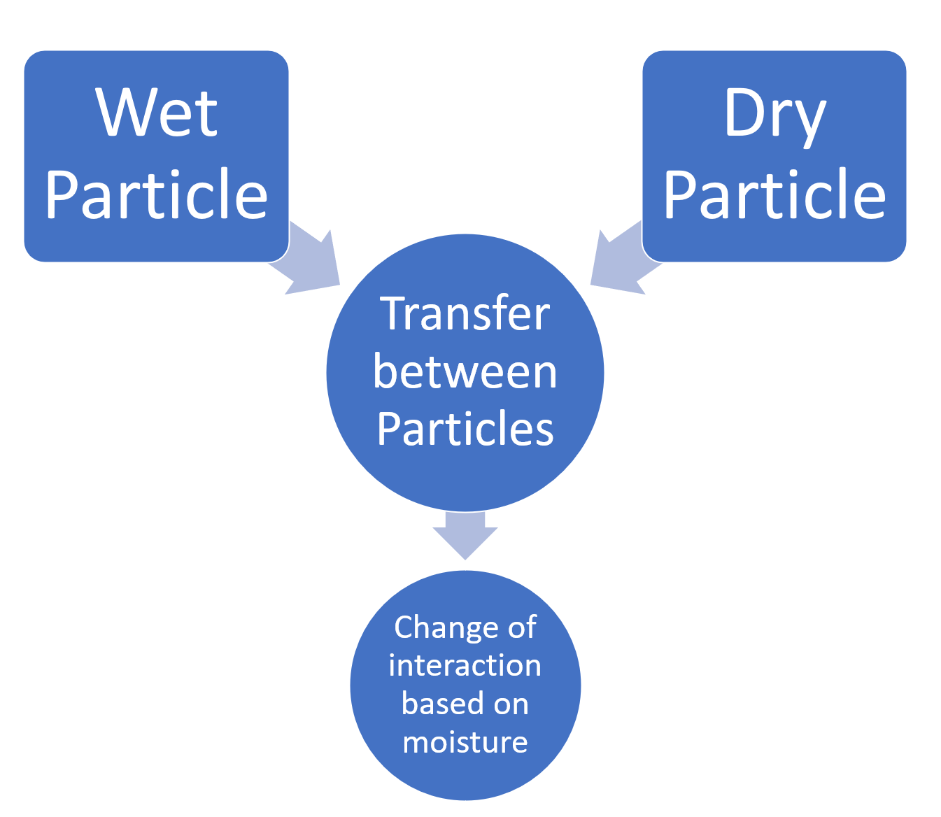

This model is aimed at cement applications as the moisture can be transferred to drier particles while mixing. The level of moisture in the model alters the interaction behavior of the particles.

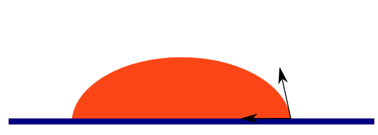

| Surface Tension | Based on the liquid which is being represented and can be found in engineering databases. |
| Wetting Angle | Indicates the angle where the surface meets the liquid. |
