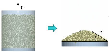

The following figure describes the angle of repose test using the lifting cylinder method. The physical measurement of the static angle of repose can be conducted according to ASTM 6393 or similar test methods.

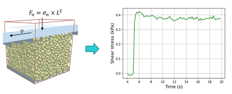

The following figure describes direct shear test under constant normal stress. The measurement of the steady state shear stress corresponds to the pre-shear stage of a shear cell test performed according to ASTM 6128 or ASTM D6773. Steady-state shear stress results are available for 1kPa and 5kPa normal stresses.

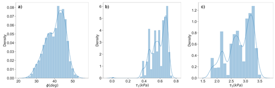

The following figure shows the 1500 material models in the database and the probability density distributions for the following responses:
- the static angle of repose
- the steady state shear stress at 1 kPa normal stress
- the steady state shear stress at 5 kPa normal stress

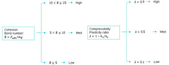

- The bulk cohesion and compressibility, which are qualitatively categorized using the bond number and the EEPA contact plasticity ratio respectively.

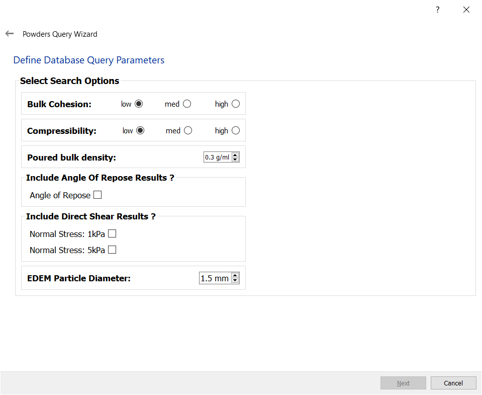

Using the EDEM Powders Database

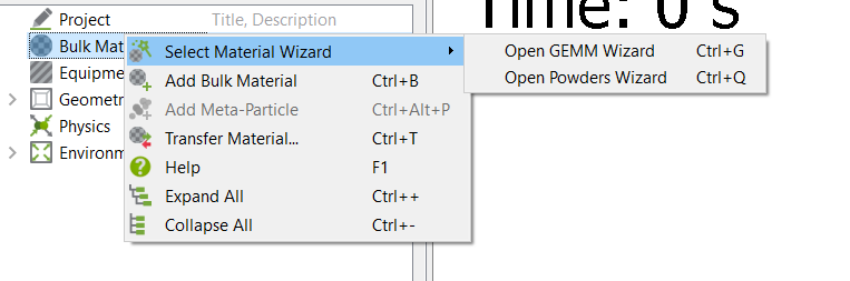

Navigate to Bulk Materials > Select Material Wizard > Open Powders Wizard to access the Powders Database.

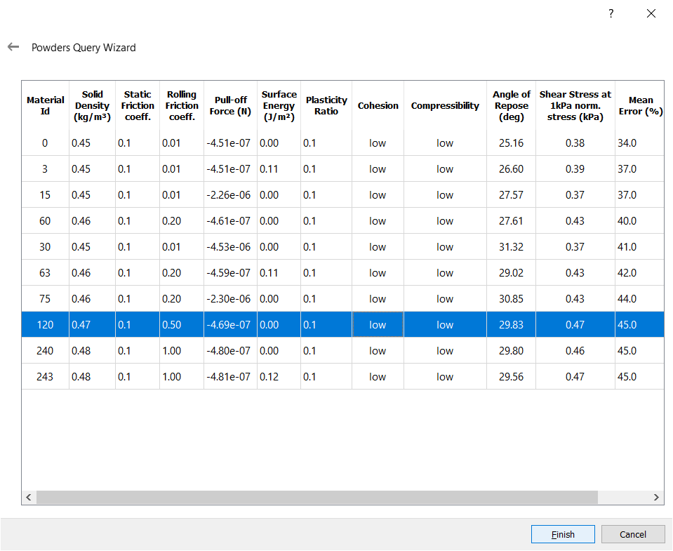

Follow the steps in the wizard and specify the input parameters for the Soils database.
In the list of materials, select an appropriate material to populate the material and model parameters in the EDEM GUI.
