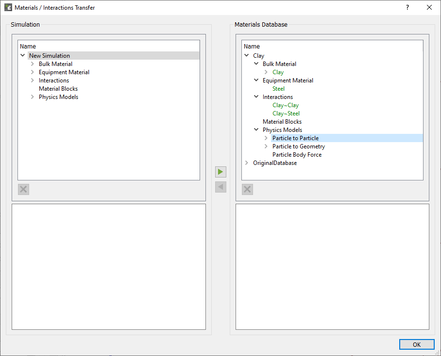

To transfer a material to or from the database:
- In the Bulk Material tab, right-click and select Transfer Material.
- In the Transfer dialog box, click the material to transfer.
The material's properties are displayed. - Click the appropriate arrow to transfer the material to or from the database.
- If a material in the model and database have the same name but different properties, they are highlighted in red to indicate the conflict.
- If you continue with the transfer, one material will overwrite the other.
- If two materials have the same name and the same properties they are both highlighted in green.
- If a Meta-Particle is in the simulation which matches the Meta-Particle name, but is a different particle definition in the database it will be highlighted in red.
- If there is a mismatch with the particle properties is used to construct the Meta-Particle, they will be highlighted in yellow.
- Equipment Materials will automatically be assigned to the Equipment Material section and Bulk Materials will automatically be assigned to the Bulk Material section of the Creator Tree.
- However, the interaction information has to be transferred separately.
