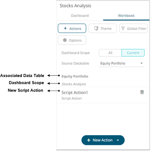

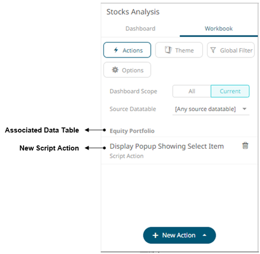

The new script action is added under the selected Dashboard Scope in the Actions list. For example, if Current is the selected dashboard scope and the source data table is Equity Portfolio, then it will be displayed as:

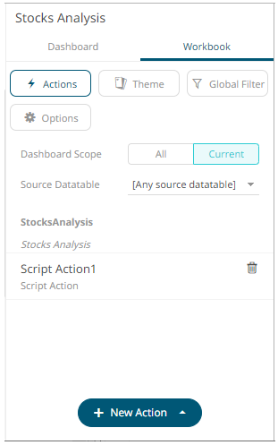

However, if no source data table is selected, then the first one in the Data Table pane (i.e., StocksAnalysis) is the default associated to the new script action.

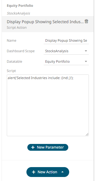

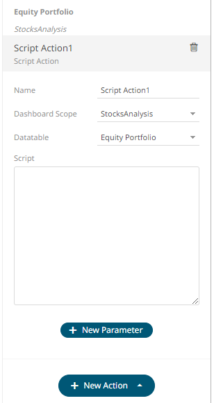

5. Click the new script instance to expand and display the properties that you can define.
6. Enter or select the following properties:
Setting |
Description |
Name |
The name of the script action and then click
Dashboard Scope |
The dashboard where you will define the dashboard scope data parameters that will be passed to the target dashboard. Can either be [All Dashboard] or the current dashboard. |
Datatable |
The source data table. This will eventually be displayed above the script action instance. |
Script |
The parameterized script. The parameters are written within curly brackets, {ParameterName}. For script actions allowing multiple value input, you can optionally specify a value separator within the curly brackets where you put the parameter name. The syntax is as follows: {ParameterName:Separator} For example: {Company:|} Default separator is comma. At execution, the parameter will be replaced with real field values associated with the selected visualization node. NOTE: The entered JavaScript should not include constructs that utilize curly brackets, as these are reserved for the processing of parameters. In addition, the entered JavaScript should not include single line comments |

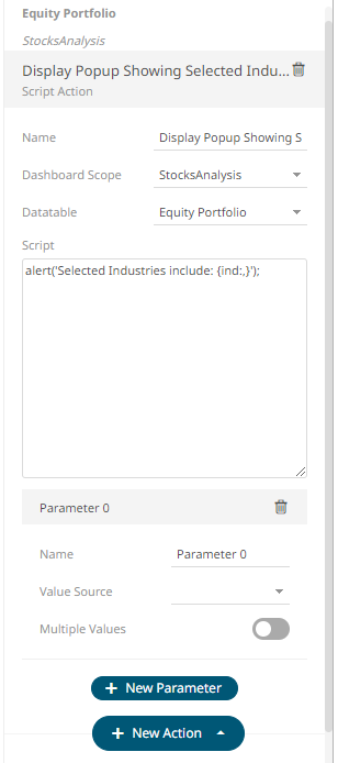

7. Click the
button to add parameters to the
output script. A new parameter instance is added.
8. Click on the parameter instance to expand and define its properties.
For each parameter added, set or select the following properties:

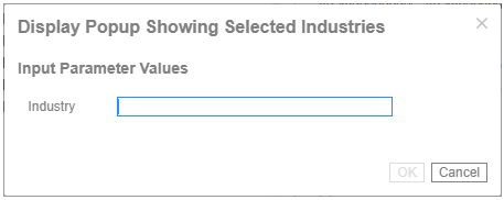

Both fields are enabled when an interactive parameter (i.e., $Interactive) is selected in the Value Source drop-down list. Typically, interactive parameters are used to pass data back to data repositories or external systems. When an action is executed which require an interactive parameter, an associated dialog box will be displayed. For example:
Add a custom Input Validation. This can be any regular expression (e.g., “A-Z{3}”) The parameter will not be updated unless it passes the validation. Enter an Error Message to help in defining a better input to match the regular expression (e.g., “Please use a 3-letter code.”) |

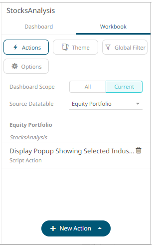

10. Click the Save
icon on the toolbar to save the
changes.
When
saved, the
notification is displayed.
Clicking the All Dashboard Scope, the new script action is available.
If the Dashboard Scope is [All Dashboard], the new script action will be displayed as:
