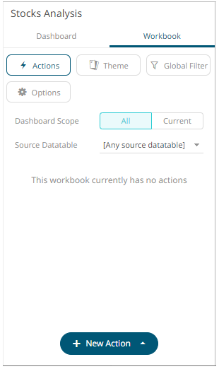

The Actions pane is displayed. Initially, there are no actions defined for the workbook and the selected Dashboard Scope is All.

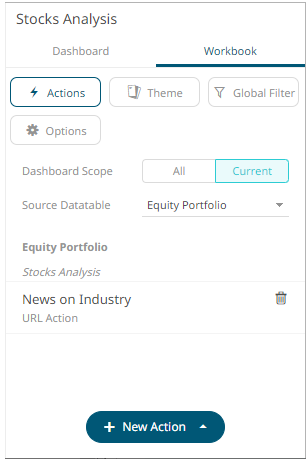

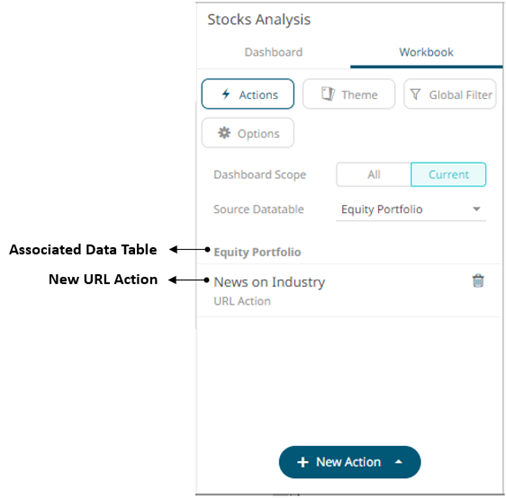

The new URL action is added under the selected Dashboard Scope in the Actions list. For example, if Current is the selected dashboard scope and the source data table is Equity Portfolio, then it will be displayed as:
However, if no source data table is selected, then the first one in the Data Table pane (i.e., StocksAnalysis) is the default associated to the new URL action.

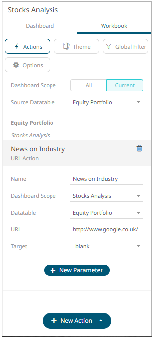

5. Click the new URL action instance to expand and display the properties that you can define.
6. Enter or select the following properties:

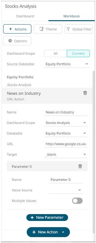

button to add parameters to the
output URL. A new parameter instance is added.
8. Click on the parameter instance to expand and define its properties.

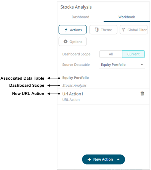

Clicking the All Dashboard Scope, the new URL action is available.
If the Dashboard Scope is [All Dashboard], the new URL action will be displayed as:
