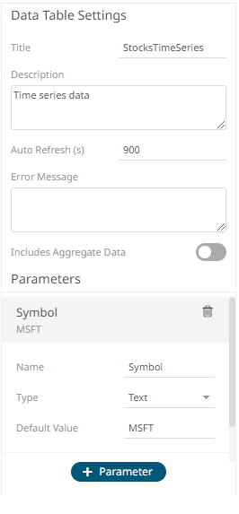

Panopticon Real Time will dynamically update the SQL query to use the parameters you have set up by putting the parameter name within curly brackets: {parameter}. Adding a dollar symbol prefix to the parameter is still supported for backward compatibility.
In this example, the software will replace the {Symbol} item in the SQL query with the Default Value.
In our example below, the Default Value is set to MSFT, the stock ticker symbol for Microsoft.
Based on this parameter setup, Panopticon Real Time will dynamically update this SQL Query:
SELECT * FROM Static WHERE Ticker = {Symbol}
and replace it with this:
SELECT * FROM Static WHERE Ticker = MSFT
