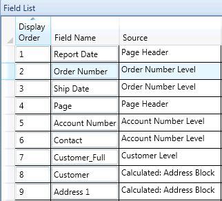

Moving a field using the Field List dialog
Select Field List from the Table Design ribbon. The Field List window displays. This window displays the properties for all fields in the table, including the field types.
Select the row corresponding to the field you wish to move.
Select the Move Up or Move Down buttons at the bottom of the field list.
Repeat step 2-3 to move any additional field.
