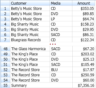

When Monarch Classic builds a summary, it generates a list of all unique values found in each key field. These lists are combined to form the summary matrix. Each line in the summary matrix represents a set of unique key values. For example, in the following summary, the fields Customer and Media are used. The Customer field contains 20 unique values, one for each customer in the report. The Media field contains 5 unique values, one for each media type in the report. In combination, these two fields can create a summary matrix of up to 100 lines, (20 customers * 5 media types). In practice, the summary would likely contain fewer lines, since not all media types are present for each customer (see illustration below).
Summary matrix created for 20 customers and five media types.

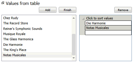

Values from Table
With this option you can create a list of specific values that Monarch Classic will use for each key field, as well as specify the mapping of the values to that list.

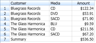

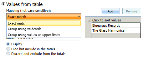

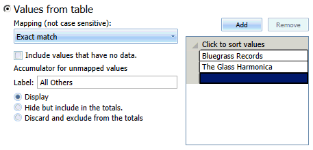

Using specified values to display information for only two customers (Bluegrass Records and The Glass Harmonica).
Within Values from table, you have three mapping choices:
Exact Match
Using Exact match, you only group according to the key values that are listed. In the example above, you only group according to the four customers listed.

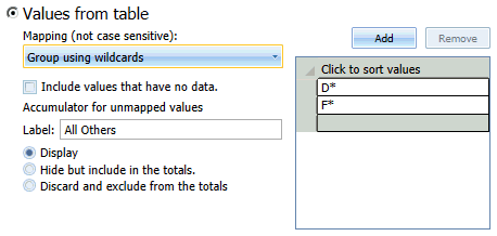

Group using wildcards
Group using wildcards works almost like Exact match, but in this case you can use wildcard characters to specify the key values to include. In this way you do not have to enter all values exactly.

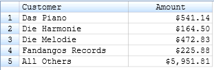

In this example, we specify to group only according to Customers that start with D and F:
And we get a summary like this:

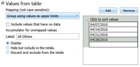

Group using values as upper limits

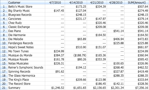

For key fields that contain date or numeric values, a somewhat different type of list might be desirable. For dates and numbers, you can create a series of ranges by specifying the upper limit for each range (e.g., 100, 200, 300 or 04/07/2010, 04/14/2010, 04/21/2010, etc.).
Using upper limit values to group Ship_date values into weekly ranges.
