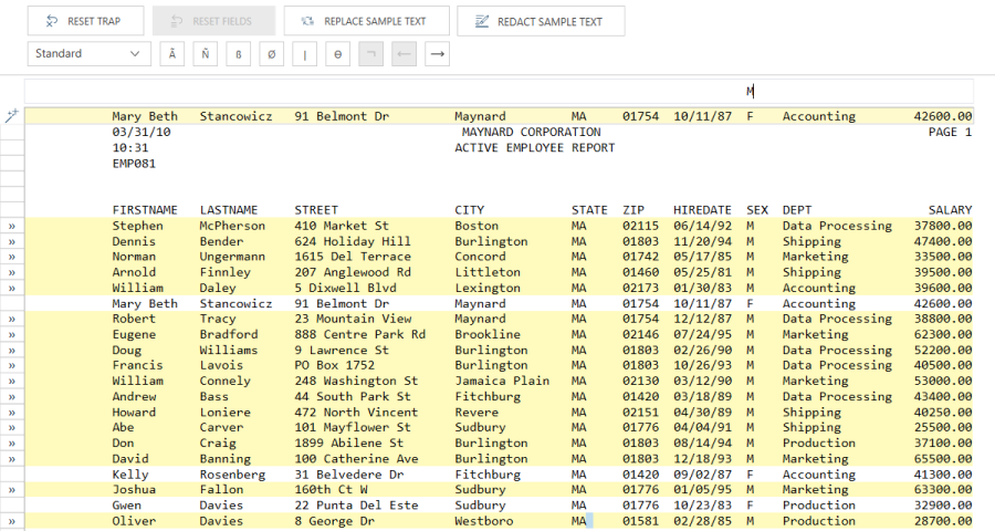

  1. In the Template Definition dialog's trap line, highlight the trap character(s) whose trapping behavior you want to reverse. The NOT trap button is activated.
In the graphic below, note that the "M" in the trap line has been highlighted. Currently the "M" is trapping the data for only the male employees (note that for the sixth employee down, "Mary Beth Stancowicz", the data has not been trapped).
  1. In the trap line, highlight the character M and then click the Toggle NOT button to reverse the behavior of the selected trap character(s), i.e., to cause it to trap data that doesn't match it.

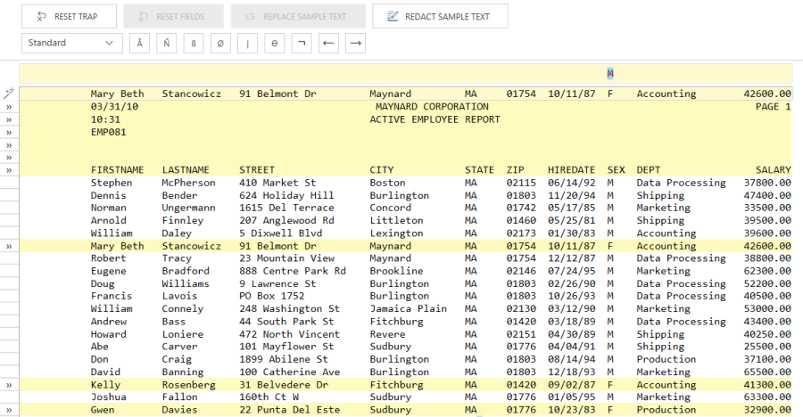

In the graphic below, note that a line has been drawn through the "M" in the trap line, indicating that its normal behavior has been reversed, and now only the data for the company's female employees is selected. Note: The "M" trap character could easily be returned to its default behavior by clicking the NOT trap icon again, so that only the data for the male employees would be selected.
Trapping the data for female employees by applying the NOT trap to the "M" trap character.
