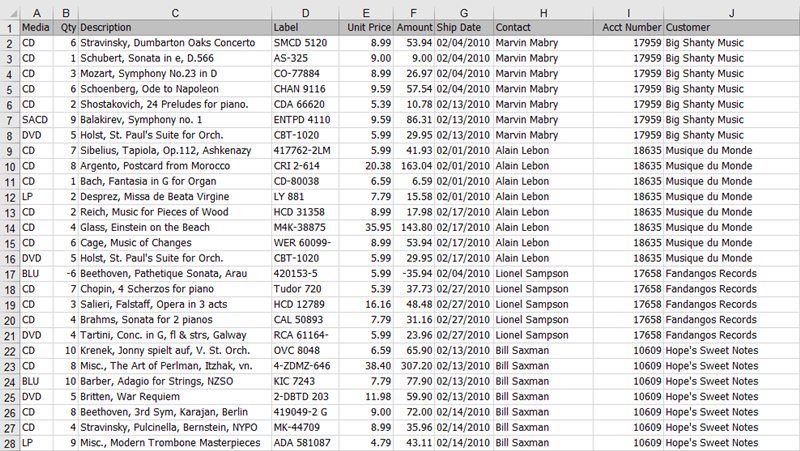

A standard worksheet.

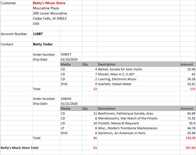

... and a worksheet that displays levels of information via formatting like this:
A worksheet with groupings (or levels of detail).

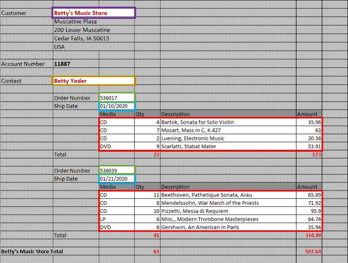

To understand how templates work, consider this worksheet showing information grouped into several levels:
Customer is the highest sort level, followed by Contact, Order Number, and then Ship Date. The columns comprising the transactions are at the detail level.
Now, imagine taking a piece of cardboard and cutting holes in it at specific locations to only show specific information. You can create cutouts for the following:
Customer (purple),
Contact (yellow),
Order Number (green)
Ship Date (blue)
Details (red)
If you then place this imaginary template on top of the Excel worksheet, only selected information will show through the holes:
The Excel worksheet, with only selected data showing through the "holes".
Worksheet Design uses electronic templates to extract data from your excel file. Instead of cutting holes, you define the traps and columns to be extracted.
