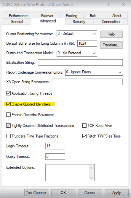

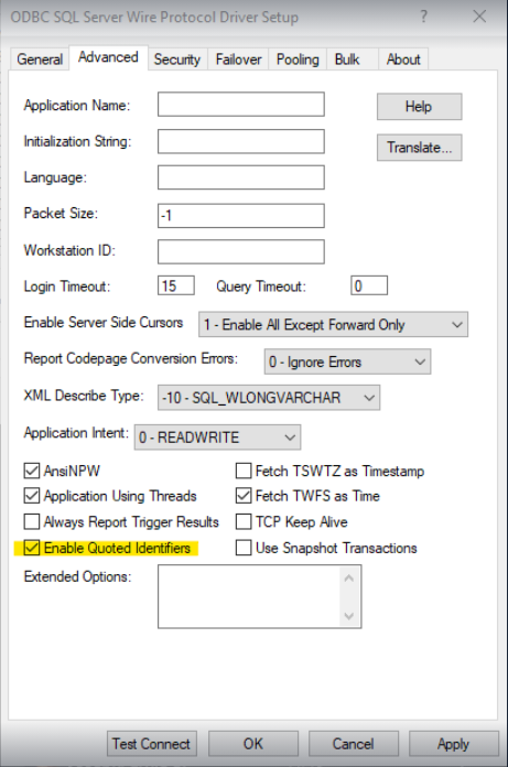

Enable "Enable Quoted Identifiers" in ODBC settings:

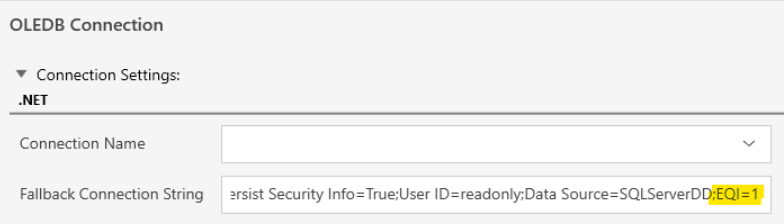

Add "EQI=1" in the Connection Settings string:
