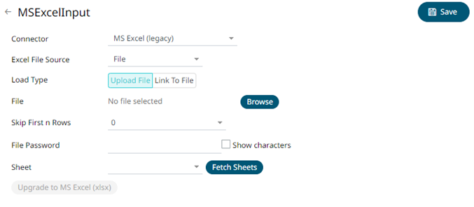

1.     In the New Data Source page, select Input > MS Excel (Legacy) in the Connector drop-down list.
2.     Select the MS Excel (legacy)  file source.
3.     Select the number of rows that will be skipped in the Excel file from the Skip First n Rows drop-down list.
4.     If the MS Excel file is password-protected, enter the File Password.
Check the Show Characters box to display the entered password characters.
    NOTE
The password is case-sensitive.
Otherwise, proceed to step 5.
5.     Click . This updates the Sheet drop-down list box and the Upgrade to MS Excel (xlsx)  button is enabled if the selected file is XLSX.

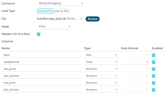

6.     You can either:
·         select the required sheet then proceed to step 7, or
·         click    to upgrade the XLSX data source to MS Excel (xlsx).
Once upgraded, the first available sheet will be automatically selected, and columns will be populated.
See Creating MS Excel (xlsx) Input Data Source for more information.
7.     Click . The new data source is added in the Data Sources list.
