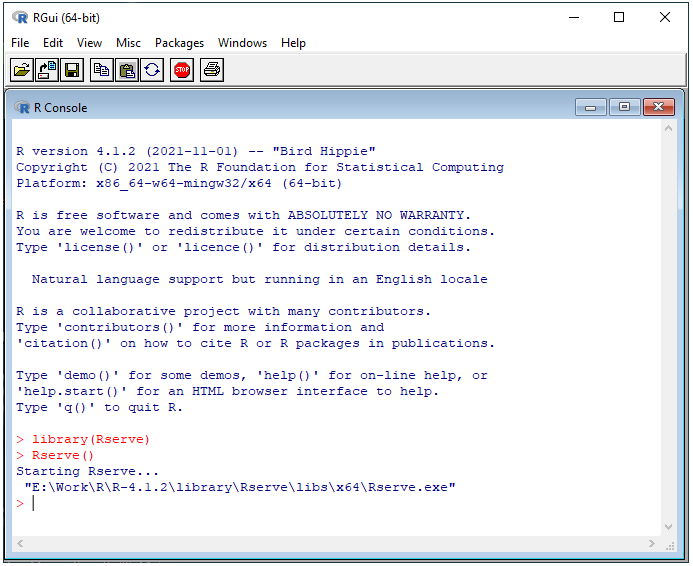

To enable R connectivity:
1. Download R, install it, and the R Console ( http://cran.rstudio.com/ )
2. Open the R Console.
3. Install Rserve using the following command from within the R Console:
install.packages("Rserve")
4. Initiatiate the Rserve library using the following command:
library(Rserve)
5. Run Rserve by executing the following command:
Rserve()
Only steps 2, 4 & 5 need to be repeated when R connectivity is required.
Example:
