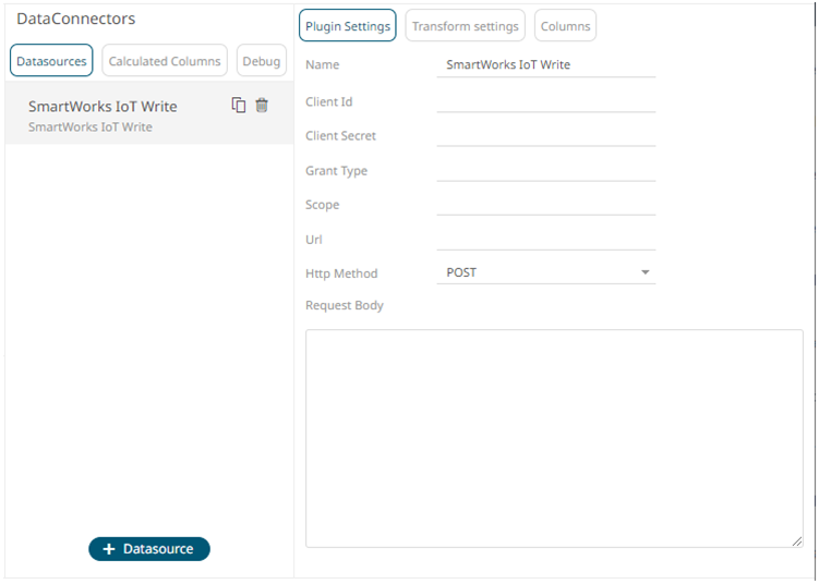

1. Select SmartWorks IoT Write from the Connectors panel. The SmartWorks IoT Write Settings panel displays.
2. Enter the Name of the SmartWorks
IoT Write data source, then click
3. Enter the Client ID, Client Secret, Grant Type, and Scope to connect to the SmartWorks IoT Write.
The Panopticon server builds up the request body formatted as application/x-www-form-urlencoded from these four fields.
4. Enter the URL that accepts PUT/POST/DELETE request.
For example:
https://api.swx.altairone.com/spaces/altair/collections/ElectronicBoards/things/01edb9j75vymj8p7qppm19h8nx
5. Specify the appropriate HTTP Method for the request from the following options:
· POST – add new data
· PUT – replace existing data
· DELETE – remove existing data
6. Enter the Request Body for the HTTP POST/PUT.
7. Click to call the service.
