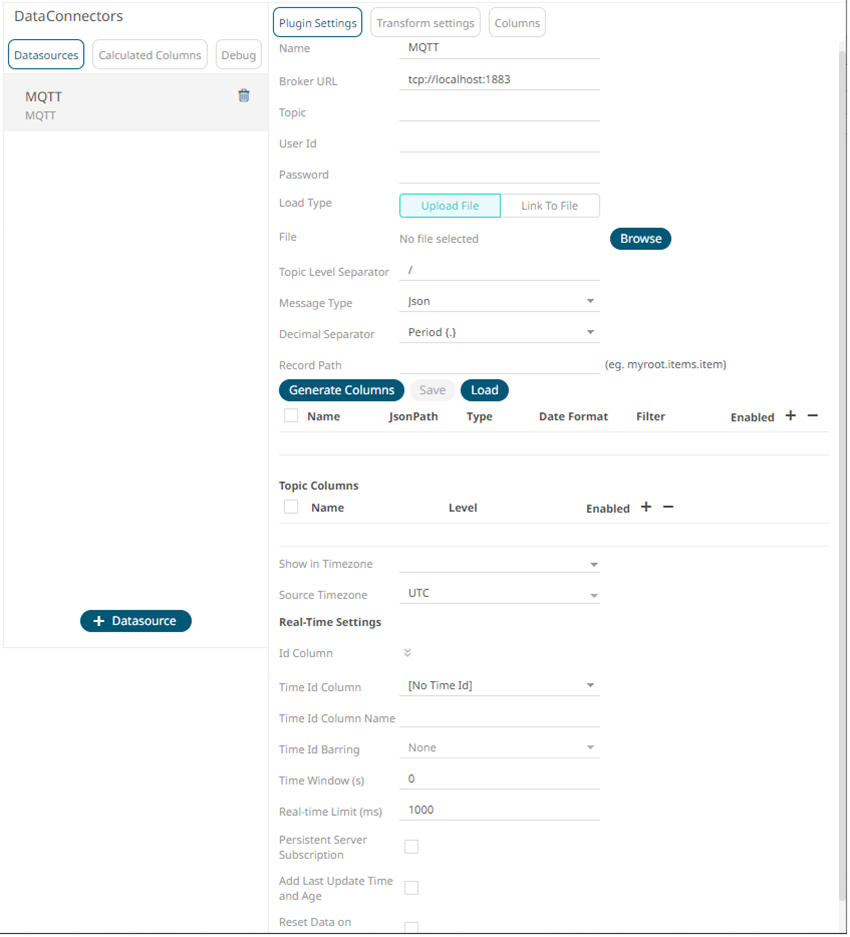

1.     Select MQTT from the Connectors panel. The MQTT Settings panel displays.
2.     Enter the Name of the MQTT data source, then click .
3.     Enter the following properties:

4.     To allow encrypted connections, you can either:
·         Upload a CA Certificate file by clicking Upload File  then Browse   to browse to the file source.
After selecting the file, it is displayed with the timestamp.
To change the certificate, click  then Browse  to browse to a new version of the file.
·         Link to a CA Certificate file by clicking Link to File   and entering the File Path.
5.     In MQTT, a topic consists of one or more topic levels. Enter the Topic Level Separator to use. Default is / (forward slash).
6.     Select the Message Type. This will specify the format of the data within the message:
7.     Select either the dot (.) or comma (,) as the Decimal Separator.

8.     Click  to the fetch the schema based on the connection details. Consequently, the list of columns with the data type found from inspecting the first ‘n’ rows of the input data source is populated and the Save button is enabled.
This also populates the Id Column with the set of columns, of arbitrary type, that can be concatenated to form a unique row identifier.
9.    You can also opt to load or save a copy of the column definition.
10.    Click  to add columns to the MQTT connection that represent sections of the message. Then enter or select:

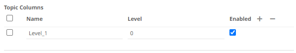

11.   Text for topic levels can be consumed as additional columns into the data table.
The Topic Columns section shows and allows defining data table columns and mapping them to topic hierarchy levels (index based from left, 0 based).
Like columns from message data, manually add them by clicking . A new entry displays.
Name can be any unique topic level within the topic name. The Level is the hierarchy level of the topic column.
Check the Enabled box to enable a topic column.
To delete a topic column, check its  or all the topic column entries, check the topmost , then click .

14.   Set the row limit of the data set.
15.   Tap the Preview Selected Data Source slider to turn it on.
16.   Click  to display the data preview.
