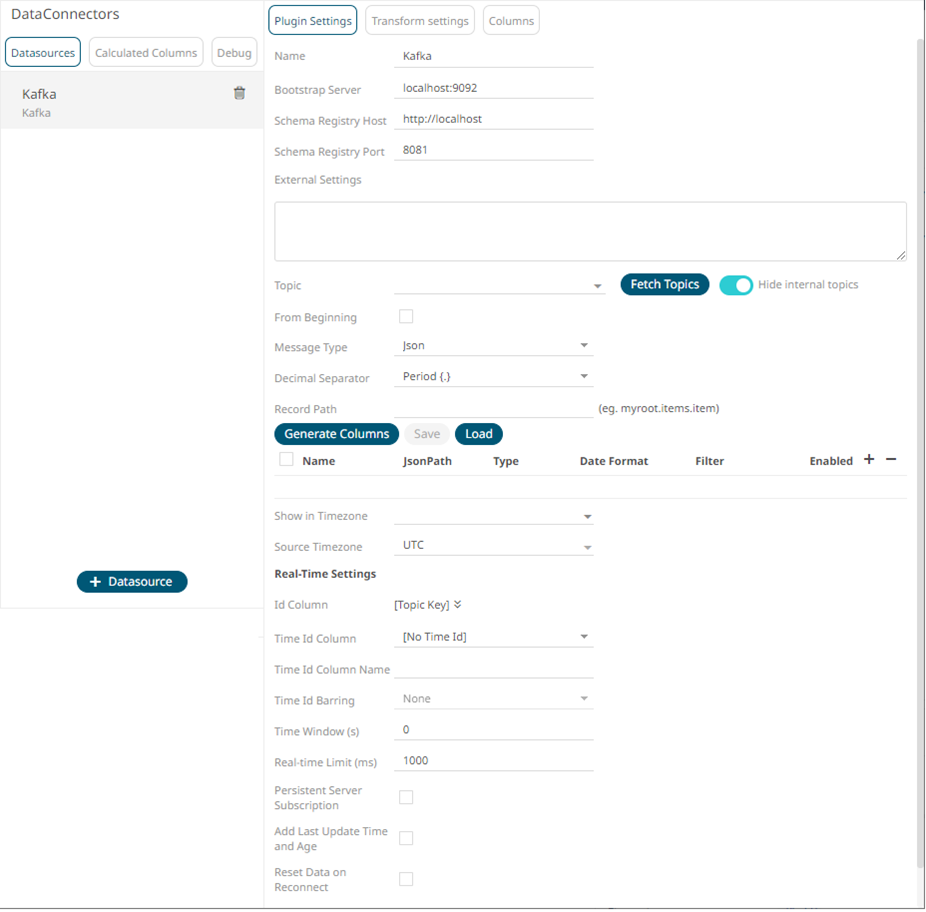

1.     Select Kafka from the Connectors panel. The Kafka Settings panel displays.
   NOTE
The key provided from the Kafka subscription is automatically selected as the Id Column.
2.     Enter the Name of the Apache Kafka data source, then click .
3.     Enter the connection details:
Property
Bootstrap Server
List of host/port pairs of Kafka servers used to bootstrap connections to a Kafka cluster.
By default, the value is localhost:9092. However, this can be overridden by specifying another bootstrap server in the External Settings text box (as specified in step 4).
Schema Registry Host
Where the Schema Registry is located. This can be in a different location from the Kafka cluster.
Schema Registry Port
The port number of the schema registry which provides the serving layer for the metadata. Default is 8081.

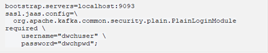

4.     Enter the External Settings to support authentication (i.e., username and password). Note that if the bootstrap server is not secure, then there is no need to authenticate and you may leave this text box blank.
Below is an example of system settings for an SASL authentication:
bootstrap.servers=localhost:9093 sasl.jaas.config= org.apache.kafka.common.security.plain.PlainLoginModule required username="dwchuser" password="dwchpwd";

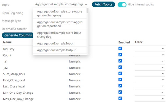

5.     Click .The first topic in the Topic drop-down list is selected and the schema is displayed.

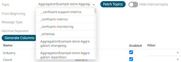

By default, the Hide Internal Topics toggle button is enabled and the Avro message type is selected.
Tap the slider to turn it off. The internal Kafka topics are also displayed in the drop-down list.
6.     Click the drop-down list to search and select the desired topic.

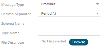

·         If Protobuf is selected, confirm the Decimal Separator, and enter the Schema Name and Type Name.
Then click    to select the File Descriptor (.desc file) in the Open dialog.
Property
Schema Name
The Protobuf schema.
Type Name
The message of Protobuf type that will be sent to Kafka.
File Descriptor
The FileDescriptorSet which:
·         is an output of the protocol compiler.
·         represents a set of .proto files, using the --descriptor_set_out option.
