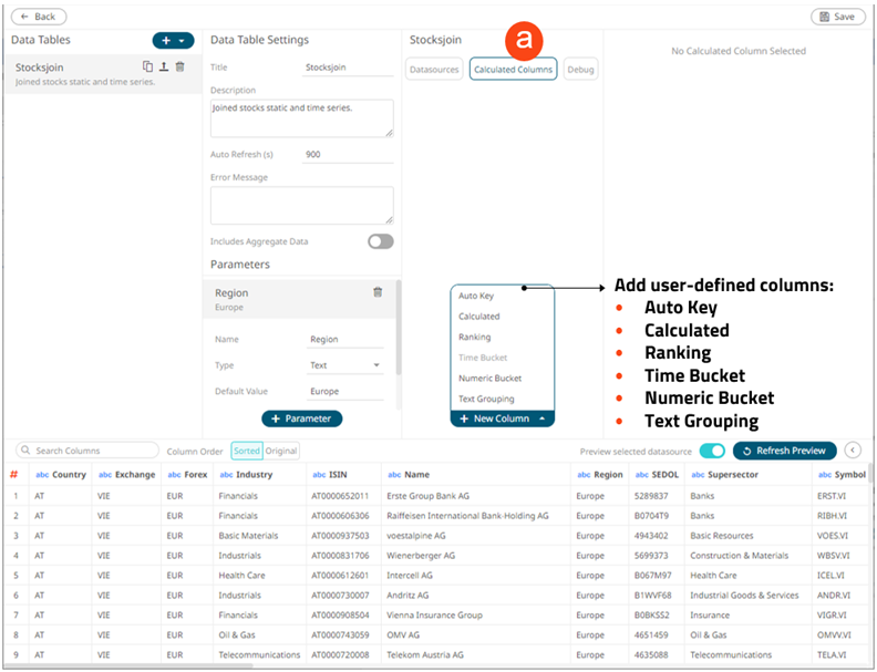

Clicking Calculated
Columns
displays
the New Column list box.
Property |
Description |
Add Auto Key |
Allow creation of an auto key for the data schema on the Data Sources Preview. |
Add New Calculated Column |
Allows creation of a calculated column from the existing columns in the data table. |
Add New Ranking Column |
Allows creation of a new numeric column based on the ranking of columns in your data. |
Add New Time Bucket Column |
Allows creation of time buckets (categorical time analysis). |
Add New Numeric Bucket Column |
Allows creation of Identity, Sign, Manual, Equal Density, and Equal Distance columns. |
Add New Text Grouping |
Allows creation of a grouping based on source text column. |

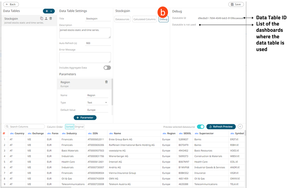

Clicking Debug
displays the Debug
pane.
Property |
Description |
Datatable Id |
Id of the data table. Can be used for parsing of server logs. |
Datatable is used on dashboard(s) |
List of dashboards where the data table is used. If a data table is not used, it can be deleted. |

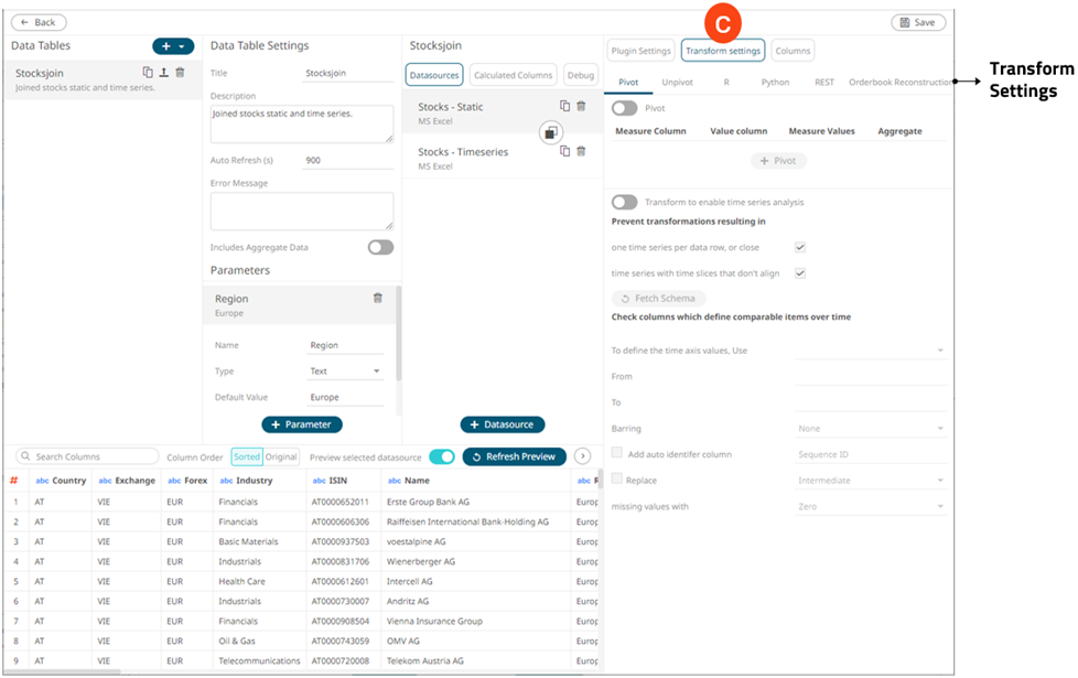

Clicking Transform
Settings
displays
the Transform Settings pane.
Property |
Description |
Transform Settings |
Allows you to perform the following: · pivoting or unpivoting retrieved data · transforming data to enable time series analysis including interpolation · running an R or Python script for data transformation · lists of orders to be reconstructed into an Order Book and conflated for output display |
