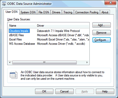

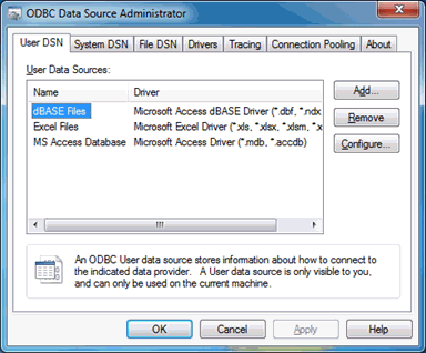

The Altair ODBC Drivers are set up using Windows' ODBC Data Source Administrator.
  1. Select Start > Control Panel > Administrative Tools > Data Sources (ODBC).
  2. Select Add.
  3. From the Create New Data Source dialog that displays, select an Altair Driver to set up. A setup dialog for this driver displays.

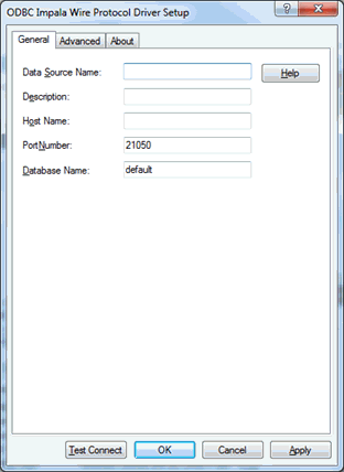

  4. Provide a data source name so that you can easily identify this driver from a list.
  5. Type in the host name and the database name you wish to gain access to.
  6. Select Test Connect to check whether or not you have the credentials necessary to access the database you named in Step 4.
  7. Enter your user name and password into the appropriate fields of the Login dialog that displays.
  8. Click OK. A message box displays to inform you of the status of your connection.
  9. Select OK on the setup dialog if you are satisfied with the test connection results.
