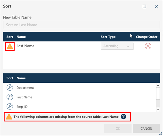

Sort
Warning on the Table Panel:
Warning on the Sort dialog box:

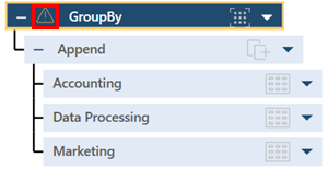

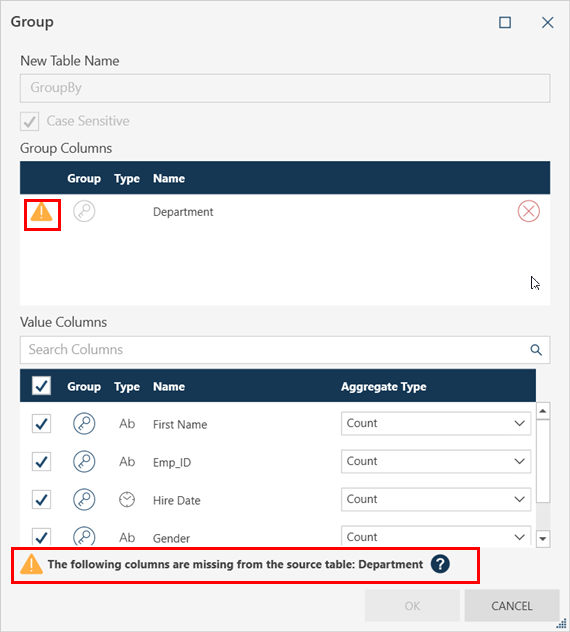

Group
Warning on the Group dialog box:

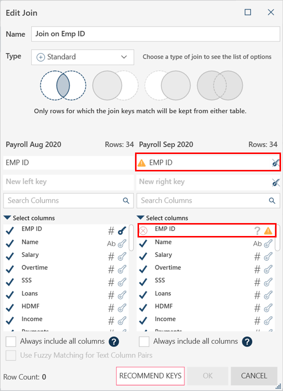

Join
Warning on the Edit Join dialog box
