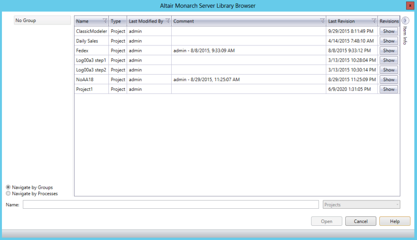

  1. Click File > Open > Project/Model > Altair Monarch Server Library. If more than one server was specified in the Altair Monarch Server Library Options dialog, you will also need to select a server from which to open the object.
    The Altair Monarch Server Library Browser displays.

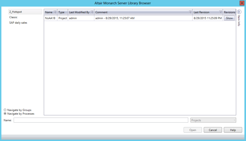

  2. Navigate to the location of the project/model by group (as shown above) or process.
  3. Select the project/model to open and then click Open.
