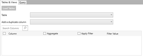

Tables and Views Section
Allows you to load, and then select, the tables from your database by manually selecting from a list.
To load tables and views via search and select:
  1. Select the Tables and Views tab.
  2. Click Load Tables to load a list of predefined tables or views.
    This list can be filtered by entering an appropriate string in the Search Tables search box.
  1. Select a table.
    The columns in the table are displayed in the Available Column list.
  1. If you wish to add a duplicate column, select this column from the Add a duplicate column drop-down list provided.
  2. Select the columns to add to your data table.
    If the data returned is to be aggregated, check the Aggregate check box. The following aggregation methods are possible:
  • Text Columns: Group By
  • Date Columns: Count, Minimum, Maximum, Group By
  • Numeric Columns: Sum, Count, Minimum, Maximum, Group By.
