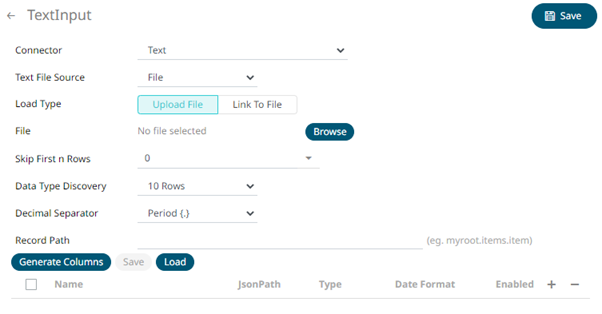

1.     In the New Data Source page, select Input > Text in the Connector drop-down list.
2.     Select the text file source:

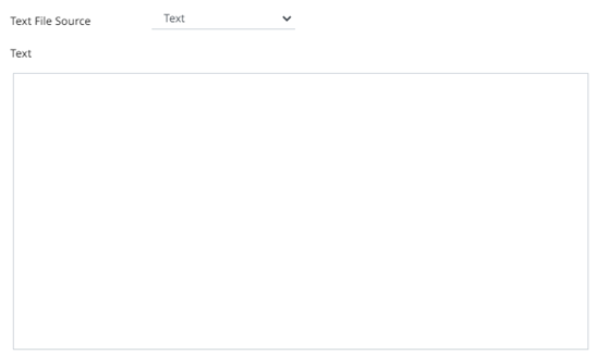

·         Text
Enter the text block to be parsed.
·         File
You can either:
¨        Upload a data source snapshot by clicking Upload File  then Browse  to browse to the file source.
After selecting the file, it is displayed with the timestamp of the snapshot.
To change the data source, click  then Browse  to browse to a new version of the file.
¨        Link to a data source file by clicking Link to File  and entering a Text File Path.
Ensure that in a cluster, you need to use a a shared path, or put it on every node and use a path that resolves on every node. You can update its contents whenever you want.

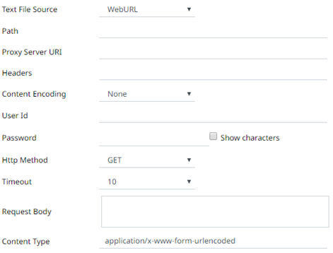

·         WebURL
The dialog changes slightly to allow specification of the following:
Property
Path
The absolute path including the http where the Text file is located.
Proxy Server URI
The HTTP Proxy setting that will allow the Text connector to reach the endpoint
Headers
·         Headers are separated by a comma
·         Each Header is entered as Name = Value, where Name and Value can be enclosed in double quotes to allow inclusion of any character except for double quotes
·         Name and Value can also be left unquoted, in which case they may not include comma or equals characters
Content Encoding
Select the Content Encoding with the HTTP Header: None, GZip, Deflate, or GZip and Deflate
User Id
The user Id that will be used to connect to the Text service.
Password
The password to connect to the Text service.
Http Method
Select the HTTP Method to map any of the following operations to HTTP requests
·         GET – retrieve information
·         POST – create or update an entity
·         PUT – replace an existing entity
·         DELETE – remove a request
Timeout
The length of time to wait for the server response (10 to 300). Default is 10.
Request Body
The Request Body for the HTTP POST.
Content Type
The required Content Type. Default is application/x-www-form-urlencoded
The standard settings controlling how the text file is parsed, is listed.
These include:
Property
Skip First N Rows
Specifies the number of rows that will be skipped.
Data Type Discovery
Specifies how many rows from the text file should be used when automatically determining the data types of the resulting columns.
Text Qualifier
Specifies if fields are enclosed by text qualifiers, and if present to ignore any column delimiters within these text qualifiers.
Column Delimiter
Specifies the column delimiter to be used when parsing the text file.
First Row Headings
Determines if the first row should specify the retrieved column headings, and not be used in data discovery.
3.     Click  to the fetch the schema based on the connection details. Consequently, the list of columns with the data type found from inspecting the first ‘n’ rows of the input data source is populated and the Save button is enabled.
4.     You can also opt to load or save a copy of the column definition.
5.     You can opt to click . A new column entry displays. Enter or select the following properties:
Property
Name
Column Index
The column index controls the position of a column. Must be >= 0.
Type
Date Format
Enabled
Determines whether the message should be processed.
To delete a column, check its  or all the column entries, check the topmost , then click .
6.     Click . The new data source is added in the Data Sources list.
