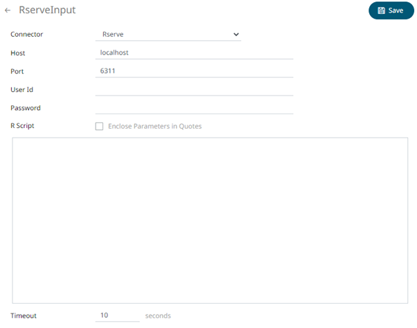

1.    In the New Data Source page, select Input > Rserve in the Connector drop-down list.
2.     Enter the following properties:
Property
Host
Rserve host address.
Port
Rserve host port. Default is 6311.
User Id
The user Id that will be used to connect to the Rserve service.
Password
The password that will be used to connect to the Rserve service.
3.     Enter the required R script to execute on the active Rserve instance.
4.     The Timeout is set to 10 seconds by default to ensure that slow running R scripts do not impact other areas of the product. You can opt to enter a new value.
5.     Select whether the parameters should be automatically enclosed in quotes by checking the Enclose parameters in quotes box.
6.     Click . The new data source is added in the Data Sources list.
