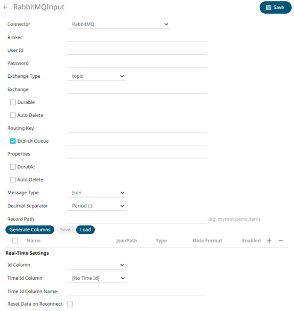

1.     In the New Data Source page, select Input > RabbitMQ in the Connector drop-down list.
2.     Enter the connection details including:
Property
Broker
The location of the message broker.
User Id
The user Id that will be used to connect to RabbitMQ.
Password
The password that will be used to connect to RabbitMQ.

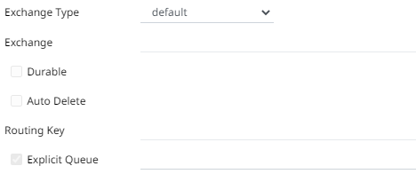

3.     Select any of the following Exchange Types:
Exchange Type
Default
A direct exchange with no name that is pre-declared by the broker.
Selecting this exchange type disables the Exchange section (Exchange and Routing Key properties).

4.     Depending on the selected Exchange Type, select or define the following:
Exchange Type Property
Exchange
Name of the exchange.
Durable
Enable so the exchange can survive a broker restart.
Auto Delete
Enable so the exchange is deleted when the last queue is unbound from it.
Routing Key
The routing key used to deliver messages to queues.
Headers
This field is only available when the message type is Header.
Binding a queue to a Headers exchange is possible using more than one header for matching. Setting x-match to any, means just one matching value is sufficient. Setting it to all means that all values must match. Default is x-match=all.
5.     Check the Explicit Queue box and enter the custom queue name. Then enter or enable the following properties:
Queue Property
Properties
The custom queue property.
Durable
Enable so the queue can survive a broker restart.
Auto Delete
Enable so the queue that had the least consumer will be deleted when that connection closes.
6.     Select the Message Type.
7.     Select either the period (.) or comma (,) as the Decimal Separator.
   NOTE
Prepend 'default:' for the elements falling under default namespace.
8.     Click  to the fetch the schema based on the connection details. Consequently, the list of columns with the data type found from inspecting the first ‘n’ rows of the input data source is populated and the Save button is enabled.
