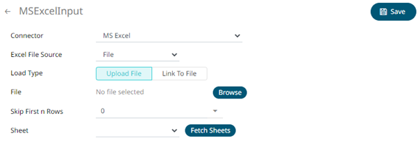

1.     In the New Data Source page, select Input > MS Excel in the Connector drop-down list.
2.     Select the Excel file source:
·         File
You can either:
¨        Upload a data source snapshot by clicking Upload File  then Browse  to browse to the file source.
After selecting the file, it is displayed with the timestamp of the snapshot.
To change the data source, click  then Browse  to browse to a new version of the file.
¨        Link to a data source file by clicking Link to File  and entering a Excel File Path.
Ensure that in a cluster, you need to use a a shared path, or put it on every node and use a path that resolves on every node. You can update its contents whenever you want.

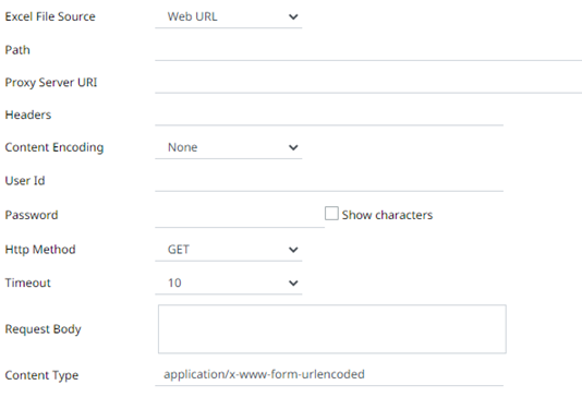

·         WebURL
The dialog changes slightly to allow specification of the following:
Property
Path
The absolute path including the http where the Excel file is located.
Proxy Server URI
The HTTP Proxy setting that will allow the Excel connector to reach the endpoint
Headers
·         Headers are separated by a comma
·         Each Header is entered as Name = Value, where Name and Value can be enclosed in double quotes to allow inclusion of any character except for double quotes
·         Name and Value can also be left unquoted, in which case they may not include comma or equals characters
Content Encoding
Select the Content Encoding with the HTTP Header: None, GZip, Deflate, or GZip and Deflate
User Id
The user Id that will be used to connect to the Excel service.
Password
The password to connect to the Excel service.
Http Method
Select the HTTP Method to map any of the following operations to HTTP requests
·         GET – retrieve information
·         POST – create or update an entity
·         PUT – replace an existing entity
·         DELETE – remove a request
Timeout
The length of time to wait for the server response (10 to 300). Default is 10.
Request Body
The Request Body for the HTTP POST.
Content Type
The required Content Type. Default is application/x-www-form-urlencoded
3.     Select the number of rows that will be skipped in the Excel file from the Skip First n Rows drop-down list.
4.     Click . This will populate the Sheet drop-down list box.
5.     Select the required sheet.
6.     Click . The new data source is added in the Data Sources list.
