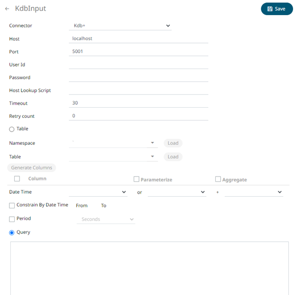

1.     In the New Data Source page, select Input > Kdb+ in the Connector drop-down list.
2.     Enter the following properties:
Property
Host
Kx kdb+ host address.
Port
Kx kdb+ host port. Default is 5001.
User Id
The user Id that will be used to connect to Kx kdb+.
Password
The password that will be used to connect to Kx kdb+.
Host Lookup Script
Key of the authentication script setting that will be searched in the connector.host.lookup.scripts property in the Streams.properties file.

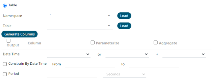

3.     When Table is selected, the section below is enabled:
The Namespace drop-down is an editable combo box.
You can either:
·         click  and select a namespace from the list of all root level namespaces. By default, the selected namespace will be root (backtick `).
·         For nested namespaces, enter them in the Namespace box (e.g., panopticon.test) to get the tables that were created under these namespaces.
4.     On the Table field, click  to populate the drop-down list with tables and views. Select a table or view.
5.     Click . The columns of the selected table or view populates the Output Column section.

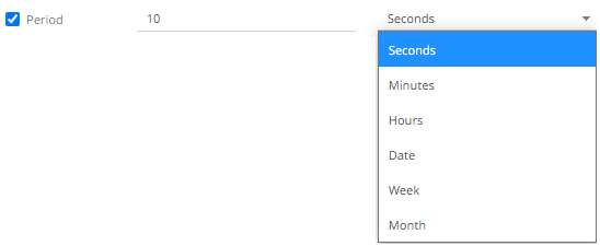

11.   In Kx kdb+, you can modify the query to regroup the aggregated data per time units (i.e., Seconds, Minutes, Hours, Date, Week, Month). Check the Period box, enter the time duration and click  then select the time unit.

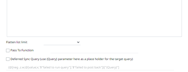

13.    Select the Flatten List Limit.
This allows retrieval of the first ‘n’ items in the list and produce new columns in the output schema with a dot notation.
For example, if there are two nested fields (BidPrices and OfferPrices) and the flatten list limit selected is five, then the output schema will be:
BidPrices.1, BidPrices.2, BidPrices.3, BidPrices.4, BidPrices.5, OfferPrices.1, OfferPrices.2, OfferPrices.3, OfferPrices.4, OfferPrices.5
If there are less than five items in the list, then the values will be null.
NOTE
Currently, this feature works for the Service subscription type. Also, it only flattens numeric columns.
14.   Check Pass to function box to activate a connection to a server using a proxy. Enter the value.
15.   You may also define a Deferred Sync Query.
