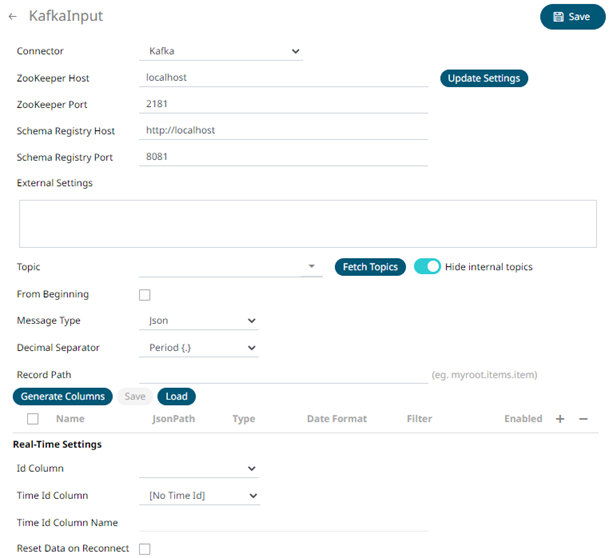

1.     In the New Data Source page, select Input > Kafka in the Connector drop-down list.
2.     Enter the connection details:
Property
Zookeeper Host
Where the Zookeeper server is located. Default is localhost.
Zookeeper Port
The port number of the Zookeeper. Default is 2181.
Bootstrap Server
After clicking , this property displays which lists host/port pairs of Kafka servers used to bootstrap connections to a Kafka cluster.
By default, the value is localhost:9092,broker:29092. However, this can be overridden by specifying another bootstrap server in the External Settings text box (as specified in step 3).
Schema Registry Host
Where the Schema Registry is located. This can be in a different location from the Kafka cluster.
Schema Registry Port
The port number of the schema registry which provides the serving layer for the metadata. Default is 8081.

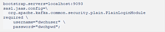

3.     Enter the External Settings to support authentication (i.e., username and password). Note that if the bootstrap server is not secure, then there is no need to authenticate and you may leave this text box blank.
Below is an example of system settings for an SASL authentication:
bootstrap.servers=localhost:9093 sasl.jaas.config= org.apache.kafka.common.security.plain.PlainLoginModule required username="dwchuser" password="dwchpwd";

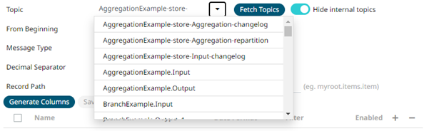

4.     Click Fetch Topics to populate the Topic drop-down list.

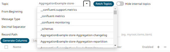

By default, the Hide Internal Topics toggle button is enabled.
Tap the slider to turn it off. The internal Kafka topics are also displayed in the drop-down list.
Click the drop-down list to search and select the desired topic.

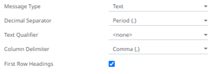

For non-Avro topics, select the Message Type: Fix, JSON, Text, or XML.
·         If Text is selected, confirm the Text Qualifier, Column Delimiter, and if the first row of the message includes column headings.
