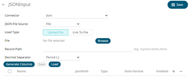

1.     In the New Data Source page, select Input > Json in the Connector drop-down list.
2.     Select the JSON file source:
·         File
You can either:
¨        Upload a data source snapshot by clicking Upload File  then Browse  to browse to the file source.
After selecting the file, it is displayed with the timestamp of the snapshot.
To change the data source, click  then Browse  to browse to a new version of the file.
¨        Link to a data source file by clicking Link to File  and entering a JSON File Path.

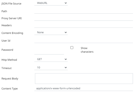

·         Web URL
The dialog changes slightly to allow specification of the following:
Property
Path
The absolute path including the http where the JSON file is located.
Proxy Server URI
The HTTP Proxy setting that will allow the JSON connector to reach the endpoint
Headers
·         Headers are separated by a comma
·         Each Header is entered as Name = Value, where Name and Value can be enclosed in double quotes to allow inclusion of any character except for double quotes
·         Name and Value can also be left unquoted, in which case they may not include comma or equals characters
Content Encoding
Select the Content Encoding with the HTTP Header: None, GZip, Deflate, or GZip and Deflate
User Id
The user Id that will be used to connect to the JSON service.
Password
The password to connect to the JSON service.
Check the Show Characters box to display the entered characters.
Http Method
Select the HTTP Method to map any of the following operations to HTTP requests
·         GET – retrieve information
·         POST – create or update an entity
·         PUT – replace an existing entity
·         DELETE – remove a request
Timeout
The length of time to wait for the server response (10 to 300). Default is 10.
Request Body
The Request Body for the HTTP POST.
Content Type
The required Content Type. Default is application/x-www-form-urlencoded
Record Path
The record path that will be queried by the JSON path (e.g., myroot.items.item).
3.     Select either the period (.) or comma (,) as the Decimal Separator.
4.     Click  to the fetch the schema based on the connection details. Consequently, the list of columns with the data type found from inspecting the first ‘n’ rows of the input data source is populated and the Save button is enabled.
5.     You can also opt to load or save a copy of the column definition.
6.     Click to add columns and specify their properties:
