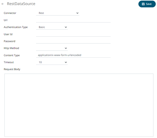

1.     On the Data Source tab, select Output > Rest in the Connector drop-down list.
2.     Define or select the following properties:
Property
URL
URL of the REST API.
Authentication Type
·         Basic
Then enter the User Id and the Password that will be used to the connect to the REST API.

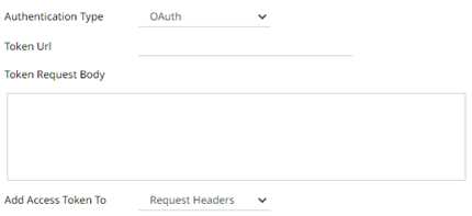

·         OAuth
Then enter the following settings:
o    Token URL – The URL to retrieve the access token from.
o    Token Request Body – The request body used for access token requests.
o    Add Access Token To - The Access token retrieved from the Token URL can be added to headers, URL or request body, depending on how the REST endpoint needs the token.
§  Request Header - A header is automatically added to the REST API request.
§  Request URL - The URL needs to be manually parameterised with a {access_token} parameter, before calling the REST API, the parameter is replaced with the actual token.
§  Request Body - The Request Body needs to be manually parameterised with a {access_token} parameter, before calling the REST API, the parameter is replaced with the actual token.
HTTP Method
Select the HTTP Method to map any of the following operations to HTTP requests
·         GET – retrieve information
·         POST – create or update an entity
·         PUT – replace an existing entity
·         DELETE – remove a request
Content Type
The required Content Type. Default is application/x-www-form-urlencoded
Timeout
The length of time to wait for the server response (10 to 300). Default is 10.
Request Body
The Request Body for the HTTP POST.
3.     Click . The new data source is added in the Data Sources list.
