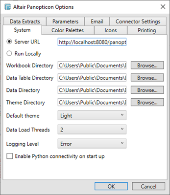

5. Open Panopticon Designer (Desktop) then select Tools > Options.
The Altair Panopticon Options dialog displays.
6. Check the Enable Python Connectivity on Start Up box then click OK.
7. Restart Panopticon Designer (Desktop).
This saves the change and enables Python connectivity whenever Panopticon Designer (Desktop) is opened.

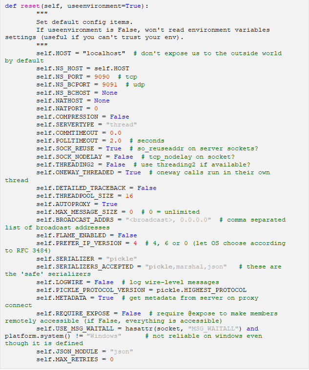

To enable the Pickle serialization, modify the configuration.py file located in ..\Anaconda3\Lib\site-packages\Pyro4 to specify the serialization to be used.
For example, if Pickle is selected, self.SERIALIZER value should be changed to pickle and self.SERIALIZERS_ACCEPTED value should be changed to include pickle:
