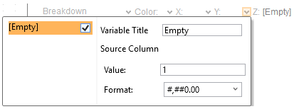

Click the down arrow
icon to the left of the Z variable. Initially, the variable has an [Empty] value.
Check the [Empty] box to enable this value.

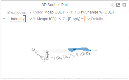

Clicking on the [Empty] value highlights this section and currently displays as the associated value of the Z variable. By default, the value is set to 1.
For example, in this 3D Surface Plot visualization, the Industry column is added as the breakdown, when the [Empty] value is selected, the Z axis will be set to 1 (0 to 1.00):
You can opt to modify the following properties:
Property |
Description |
Variable Title |
The name of the associated variable to Z. |
Value |
Value of the Z variable. |
Format |
The format the numbers will be displayed in. |
