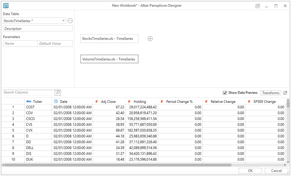

To perform the Union, the multiple source tables are added to the data table. A Join is then established from the unique ID field on the left source table to the unique ID field on the right source table.
Defining Union of Data Tables
Drag a box of a data source to the other one.

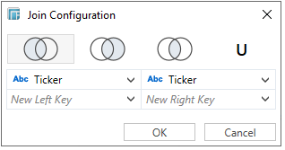

This creates a visible line connecting both tables and the Join Configuration dialog displays with the suggested join keys.

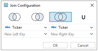

Select Union

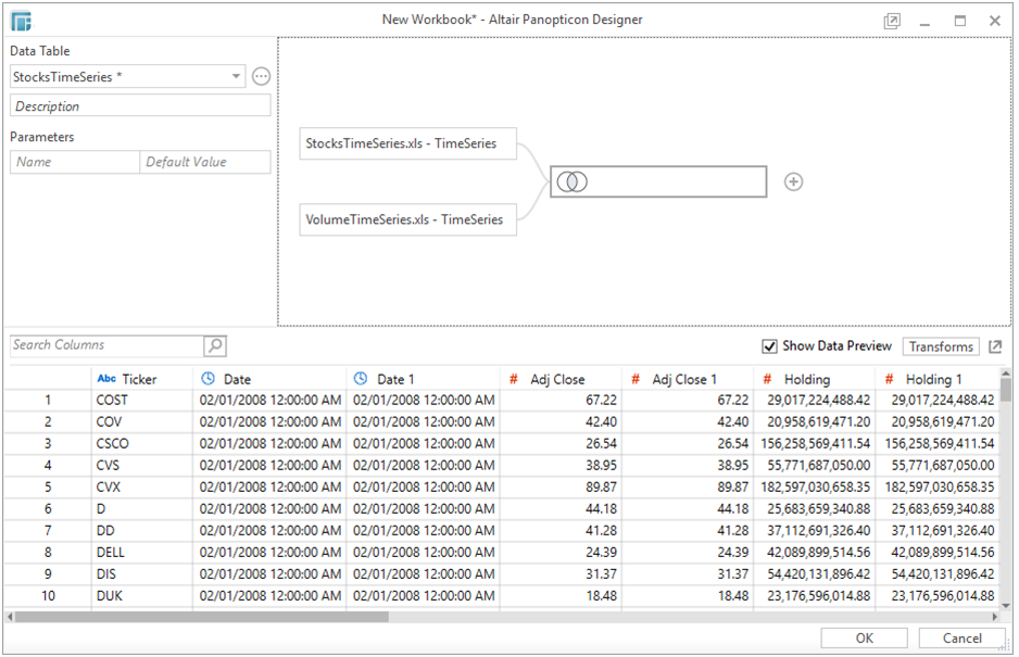

Click OK. The data set has been unioned in the Data Preview.
